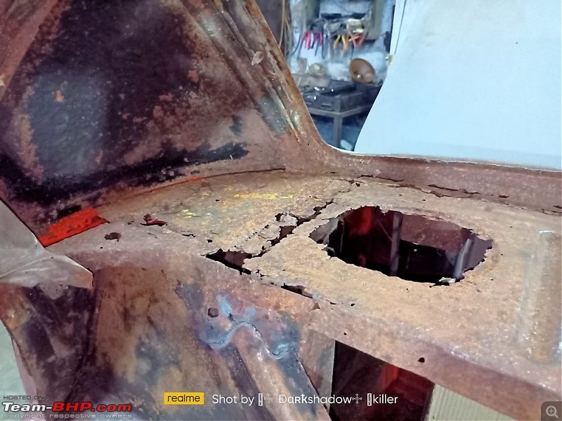

The next major area that needed attention was the rear parcel shelf and frame behind the rear seat. Also the front cowl top.

Time had come now to take off the body from the chassis as we had seen rust on chassis when we were replacing the floor boards. The rear was fine but areas on the front side needed more attention. After the repair work, we used epoxy primer and epoxy black paint on the chassis.
1957 Wolseley 6/90 Restoration Journey-img20220427wa0020.jpg
1957 Wolseley 6/90 Restoration Journey-img20220427wa0021.jpg
1957 Wolseley 6/90 Restoration Journey-img20220427wa0022.jpg
1957 Wolseley 6/90 Restoration Journey-img20220430wa0039.jpg
1957 Wolseley 6/90 Restoration Journey-img20220430wa0040.jpg
1957 Wolseley 6/90 Restoration Journey-img20220430wa0041.jpg
1957 Wolseley 6/90 Restoration Journey-img20220502wa0013.jpg
1957 Wolseley 6/90 Restoration Journey-img20220502wa0014.jpg
1957 Wolseley 6/90 Restoration Journey-img20220506wa0018.jpg
1957 Wolseley 6/90 Restoration Journey-img20220506wa0020.jpg
1957 Wolseley 6/90 Restoration Journey-img20220506wa0017.jpg
1957 Wolseley 6/90 Restoration Journey-img20220506wa0019.jpg
IndrojitSircar is offline   (24) Thanks
