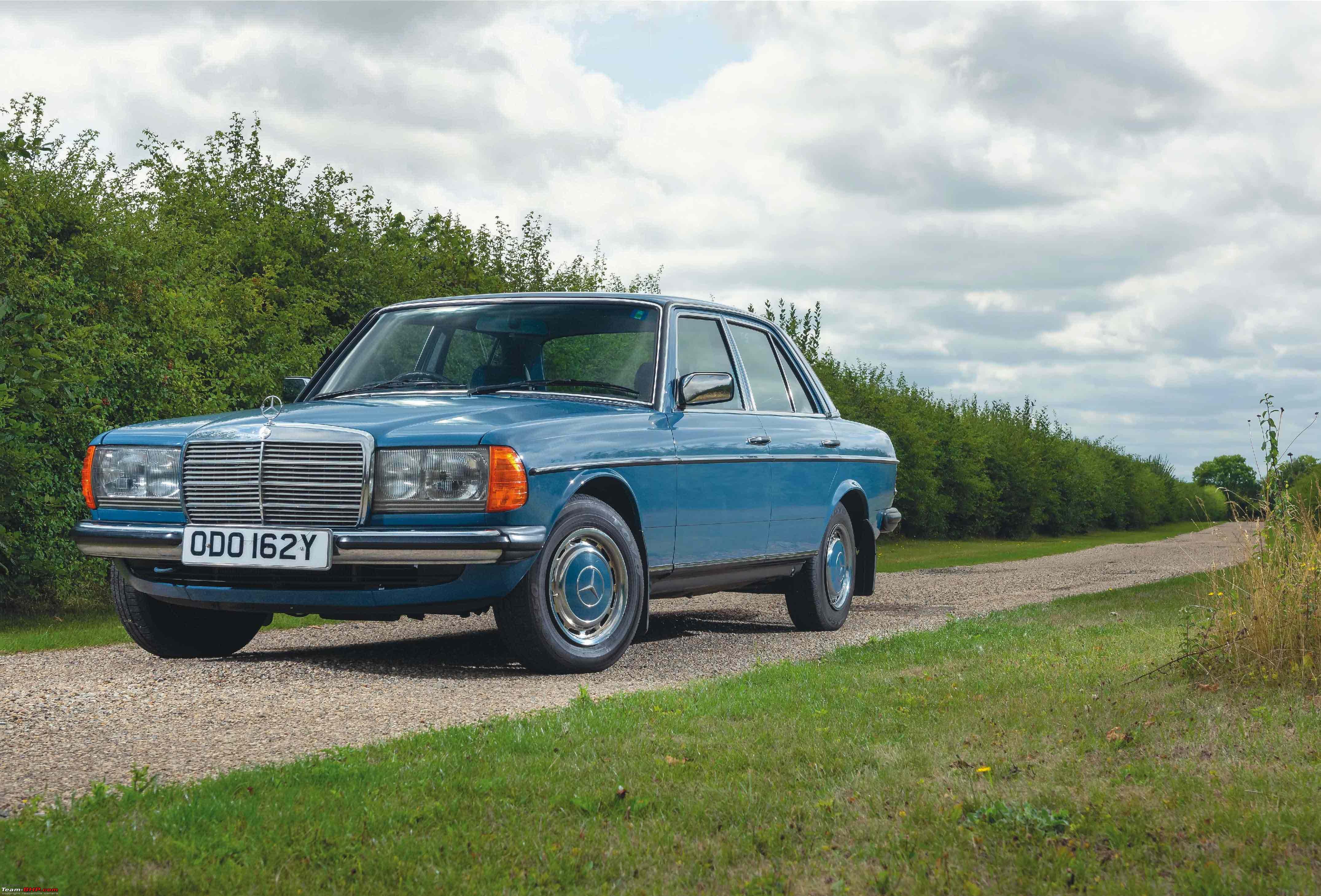

Image for reference only
Option 2: 1979 W123 – 230 Petrol (Mid-model)- Original China Blue paint with black interiors
- Currently undergoing complete restoration by a trusted specialist
- Still sometime (3 months) before it’s ready
- The final cost is expected to be around ₹19 lakh
- Strong personal nostalgia — we had a W123 growing up
