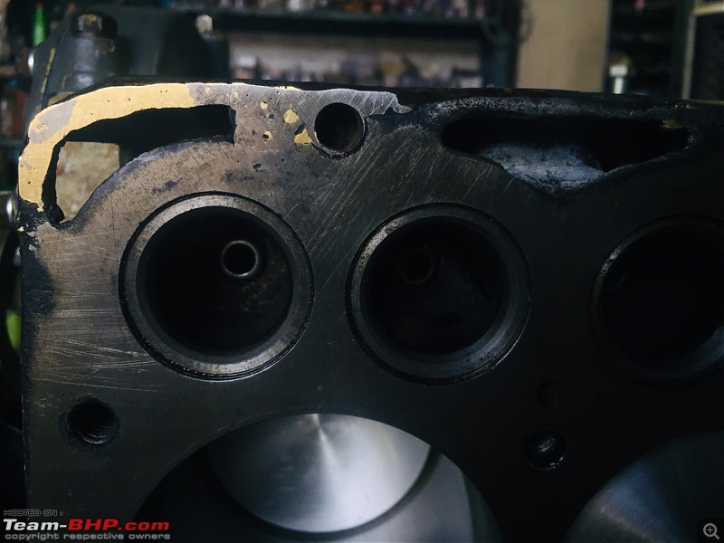

Any ideas how you will be fixing that crack in the cylinder block?
Jeroen
Bit of a grey area, I have asked the workshop for an explanation on this and will update in due course.

There are different techniques. Although it might be, technically, possible to weld, that introduces a lot of heat into the block. Which can create all sorts of problems, warping etc.
A well proven technique is so called “metal stitching”. There are several companies doing this as a service and or providing the materials:
The basics are shown in this little video
Search for metal stitching on youtube and you will find many video’s about engine block repair. Also, by DIY mechanics using this technique.
Good luck, look forward to seeing more details about the restoration!

On the method suggested by Jeroen - here's one reference to a company in Calcutta. I am sure our vintage experts in Calcutta knows further details
http://ekapress.co.in/metal-stitching.aspx
May be useful

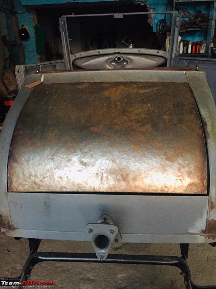

25.09.2020
More progress, an all new rumble seat has been fabricated.

The engine block is back from repair, the workshop tells me that the crack was small and easily repaired, I have asked for details and if they are going to do any tests on it to check.
It will be good to know how they tackled that issue
The resto job is coming out really well, from the pics. I am sure they would have done a good job with the engine as well.

I have been told that crack was minor and brass was used to repair it, its their local method and they say many blocks have been repaired this way.
