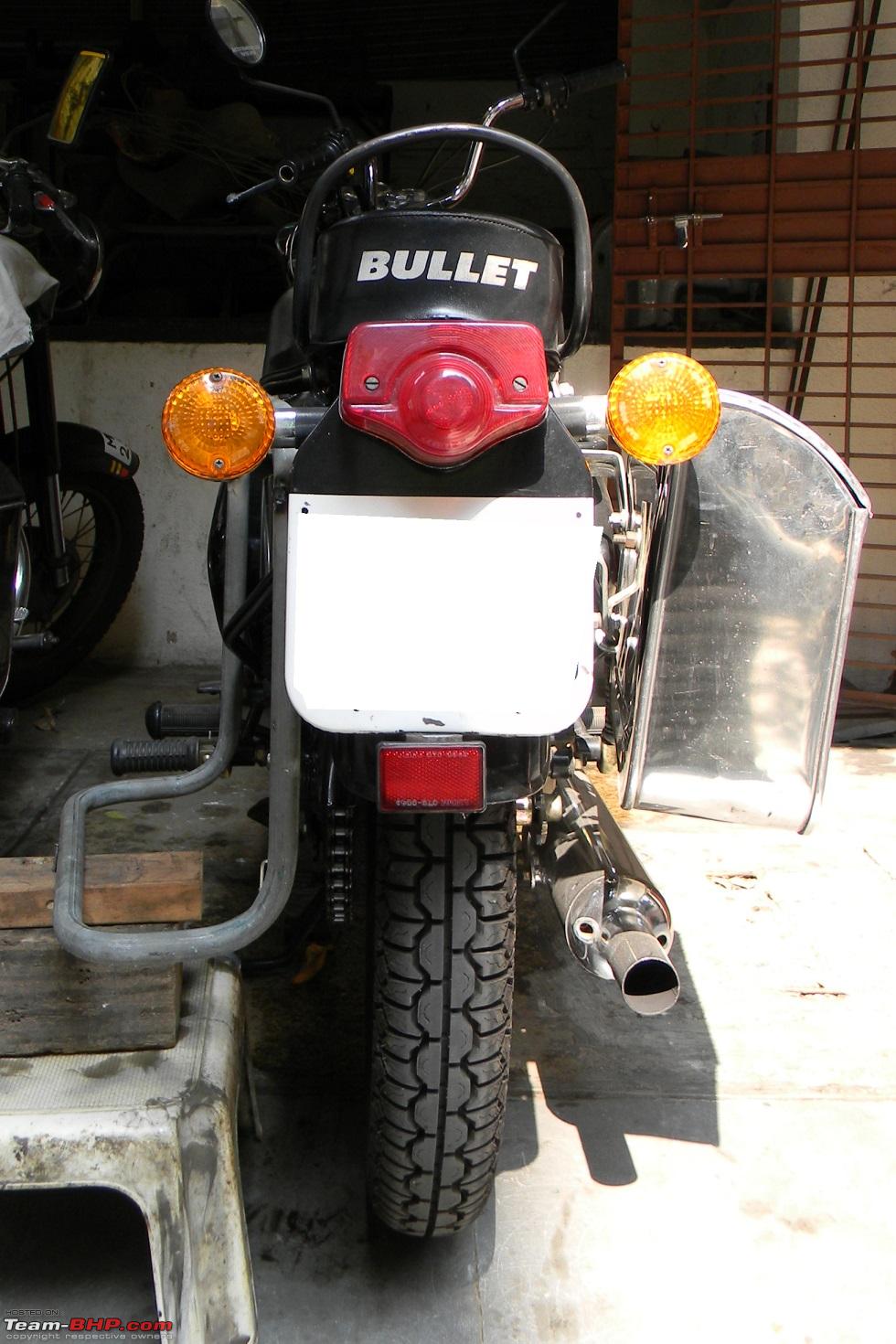

This should sound stupid : What is the feasibility of incorporating one or two small shock absorbents on to the crash guard so that the guard would move a little so that it won't twist the frame and not that far that it would trap the rider's legs? Some thing akin to the old railway buffers ?
regards adrian
DIY: Enfield 350 Crash Guard (design & build)-images.jpg
