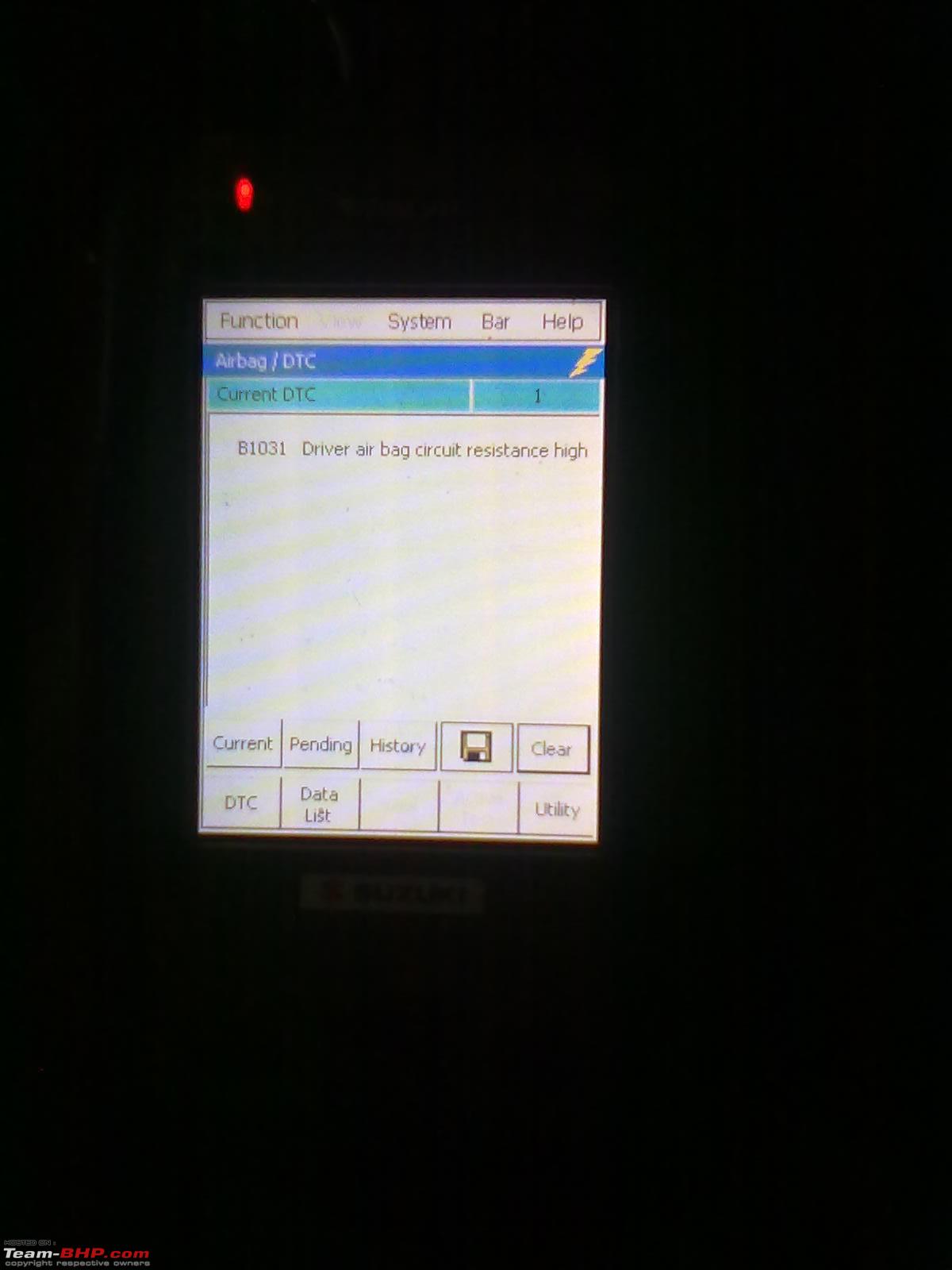

I take it to Mithra agencies,Madhapur. One dude picks up that machine ( OBD?) and insert the wire to the socket under the steering column. Some error code appears. I took a glance at the console and manage to photograph it also.
Here it is.
Does anyone know what this error code means?
(That day, Mithra guys did not seem to have a clear idea about this error code. After much running around, they told me that there is an expensive 'motor' which is connected to seat belt and airbag and its malfunctioning. It was not very convincing that that point in time, but in hindsight, after my experience with RKS motors, I feel Mithra is better. More on that later)
Has anyone come across this issue? Please shed some light on the error code and what it means.

Possibly an airbag sensor issue. I am no expert, so I am purely guessing. Do you know what exactly was done the last time? I believe the sensors would be located somewhere behind the front bumper. If the motor is at fault, why only the driver side airbag is shown as faulty? I'm curious to know the source of the problem since I have a ZXi too.

If its a airbag sensor issue it wont be just limited to Driver side airbag I guess (In the pic above it mentions driver side). Swift comes with passenger side airbag too IIRC.

With Airbags the issue generally is of connectors that connect and disconnect when the car goes over rough roads if the contact is not established well with the right kind of sockets.
The system is programmed to ignore this for a few instances of errors but once the limit is extended it would start giving errors.
Setting the number of instances permitted thought the software tool (by experts) helps at times.
At other times a disk on the Steering wheel that establishes this connection looses contact and causes an error.
Zero Contact also implies High Resistance as then resistance is infinite.

Link by aphakilo has wealth of information and they seem to suggest connector problems. ACM too is suspecting something similar.
Alphakilo, ACM, Could it be an issue with SDM itself?
The RKS Motors people are telling me that the SDM needs to be replaced. But they have not tested the car with a working SDM as the manual suggests.
FuelAddict, its not a sensor issue. When it happened for the first time, they solved it by 'reprogramming'. I did not go into the details. From what ACM says, I'm presuming that they have simply set a higher threshold.

The high resistance error may be due the circuit being open somewhere or the circuit is being completed with something in contact which is why the resistance is showing high. I think therefore since the circuit is drawing more current than usual, hence the alarm. I maybe wrong.
Its better to show it to Maruti service center and get the issue resolved. Maybe browsing back at the earlier issue records might point to something.

Sir, I dont think so a SDM will go kaput so easily. It forms part of a very critical component. Better get it checked in another Genuine maruti showroom who can do a proper testing. It could also be possible that your ECU/vehicle computer is forcing out a error signal forecasting a failing SDM, so better take the vehicle to another service station. I am sure Hyd members like Vina and many more would be able to guide you. Just PM them. And do update the post-results.

A quick look at DTC B1031 from the workshop manual, and what could be the possible issues.

SDM conking out is the last thing to check, but is a possibility. Motor replacement? What motor?
I would suspect a loose contact somewhere.

I'm kind of convinced that it is a connection problem than a sdm problem. The issue now is to find a reliable service staion. Mithra guys meant SDM when they said 'motor'. Like I said earlier, they were not at all convincing. They took 45 minutes to figure out what is B1031.

I took my car to the RKS Motors workshop in Nampally last tuesday. They replaced a part called cable assembly contact controller which sits inside the steering wheel . ( part no 37480-62j20) and the issue ceasedxto exist. It cost me Rs 3500 and was not covered under warranty , though i'm under extended warranty,since it is an electrical part or so I was told.

Aah.. yes! That's also known as the clock spring. Thanks for the update.
