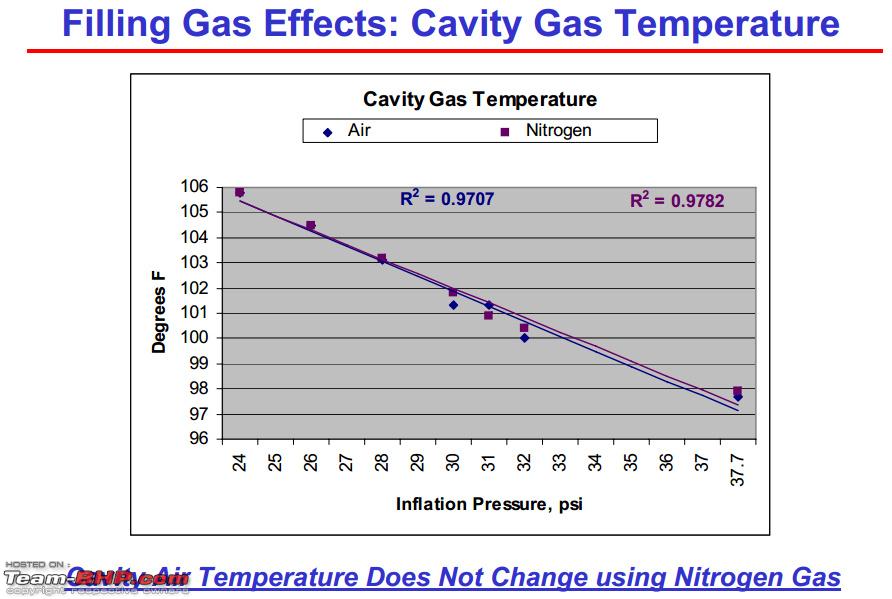

Another option is using nitrogen gas, when travelling on highways. Its available in most cities now. The gas doesn't expand with heat and helps to keep the tires cool as well.
Wrong notion. Do some reading:
http://www.edmunds.com/car-care/shou...-nitrogen.html
http://www.arb.ca.gov/cc/tire-pressu...lipr051308.pdf
