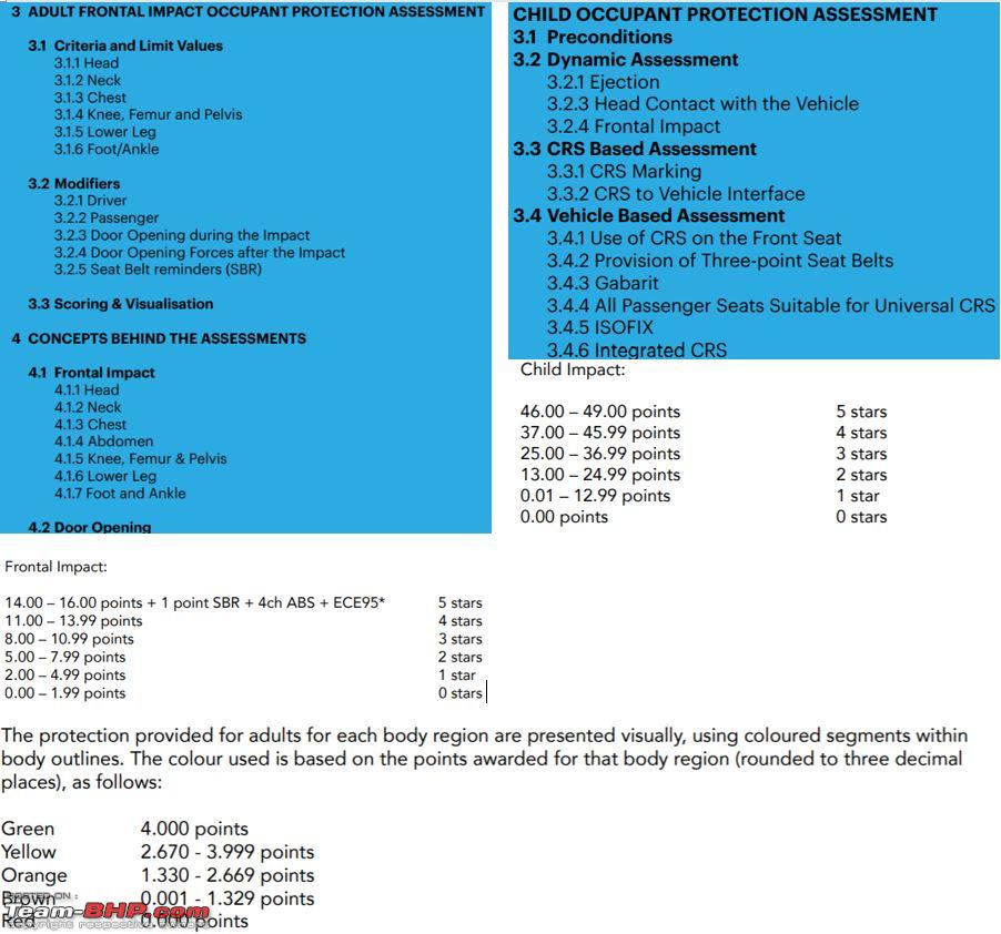

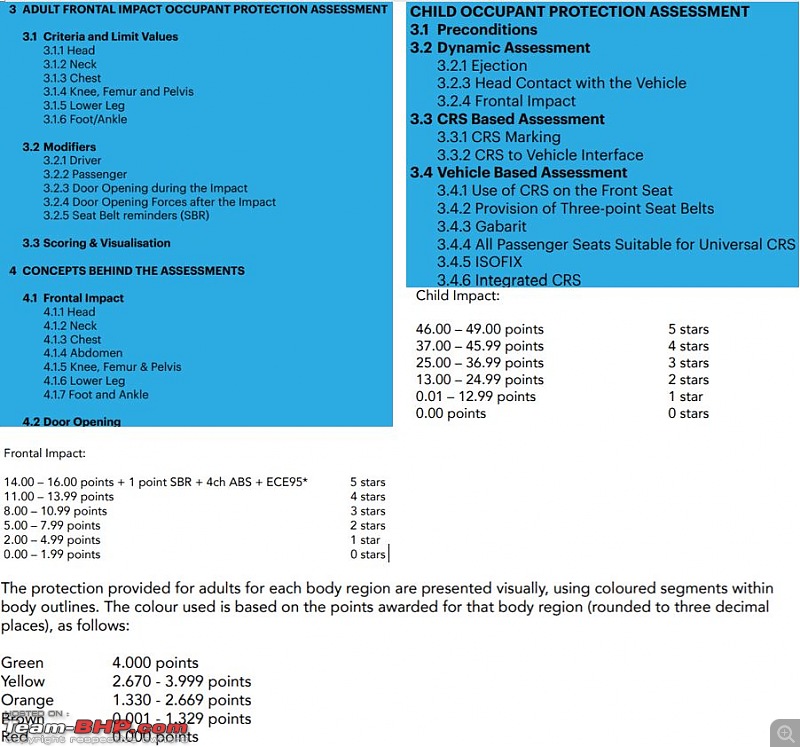

GNCAP: I cannot find a scoring sheet for GNCAP. But based on my study of protocols they are only having AOP and COP sections.
Assessment Protocols:
AOP - http://www.globalncap.org/wp-content...ocol-Adult.pdf
COP - http://www.globalncap.org/wp-content...ocol-Child.pdf
So is GNCAP ratings on AOP/COP is same as ENCAP – The answer is no, because the scoring and test procedures are slightly different.
And the test cases covered in ENCAP is more comprehensive than that of GNCAP.
But one can co-relate to the separate scenarios mentioned. And most importantly, we have at least started giving importance to some safety rating now in India. We have to go a long way, but still we have to start somewhere and that’s where we are now.
