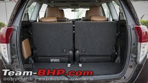

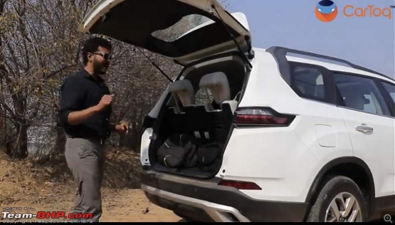

One major point that could be a deal breaker is the boot space with all seats in place. What especially disappoints me is that Renault was able to provide the same, if not more boot space in the sub 4 metre Triber, while Tata had an entire 4.6 metres to play with.
Also noticed that the headrests of the third row are dangerously close to the rear windshield. In fact, when the tailgate is open, it almost seems like the headrests are protruding out of the body work! Attaching screenshots from the Cartoq review:

Reminds me of this 9 year old video that is still highly relevant:

This lack of crumple space between boot lid and 3rd row is actually causing me immense doubts and some anxiety. I didn't realise it was so close to the rear lid.
Dilemma over 7 seater suv and 3rd row rear impact safety.
Went through all the video reviews available till 3 pm, majority of the folks gave above average recommendations.

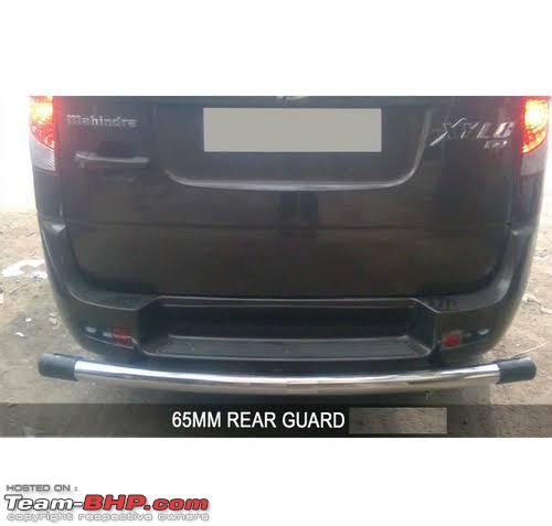

Is there a possibility of fitting a rear bull guard at the rear similar to what we do at the front?

Hello rbg,
When you say “bull guard”, I am assuming you are talking about this thing:
Concerned about the safety of 3rd-row passengers in SUVs & MPVs-8f1a59fcf06c429fb370ec8fae231459.jpeg
Many people get this fitted to avoid scratches from bikes, but if you ask me, it is absolutely useless. It doesn’t add to the safety at all, it gets bent very easily. It is just a tubular piece of metal, and is much weaker when compared to the chassis of the car. In fact it does more harm than good, because at the front, it messes up the functioning of the crumple zones, causes trouble with airbag deployment and makes the car lethal for pedestrians.
At the rear, the only purpose it can serve is that it protects your rear bumper from minor scratches from minor brushes in bumper to bumper traffic, that’s all.
But the most important thing to note is that it is ILLEGAL to fit a bull guard at all.
