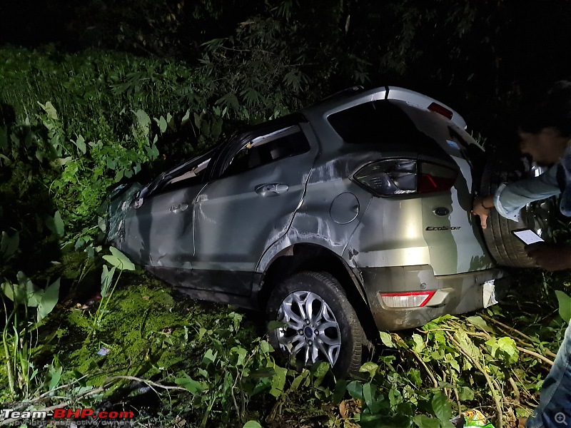

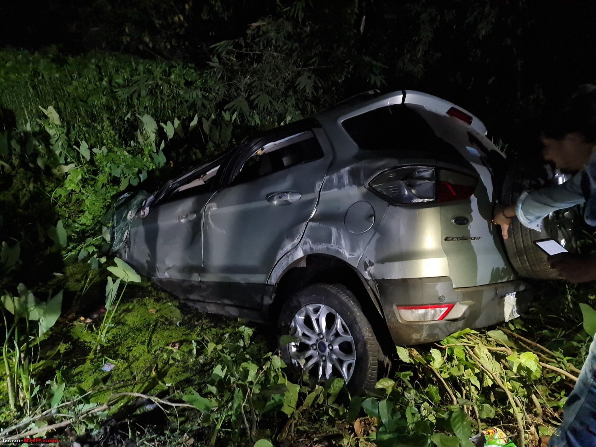

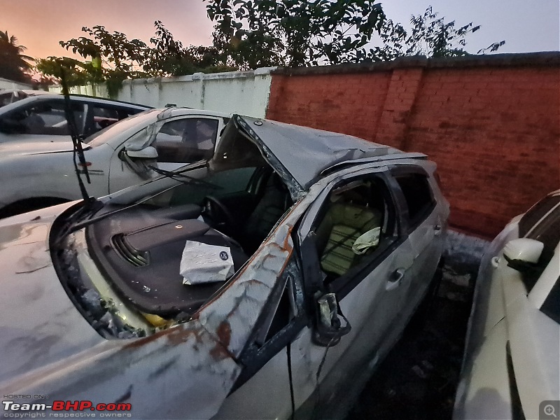

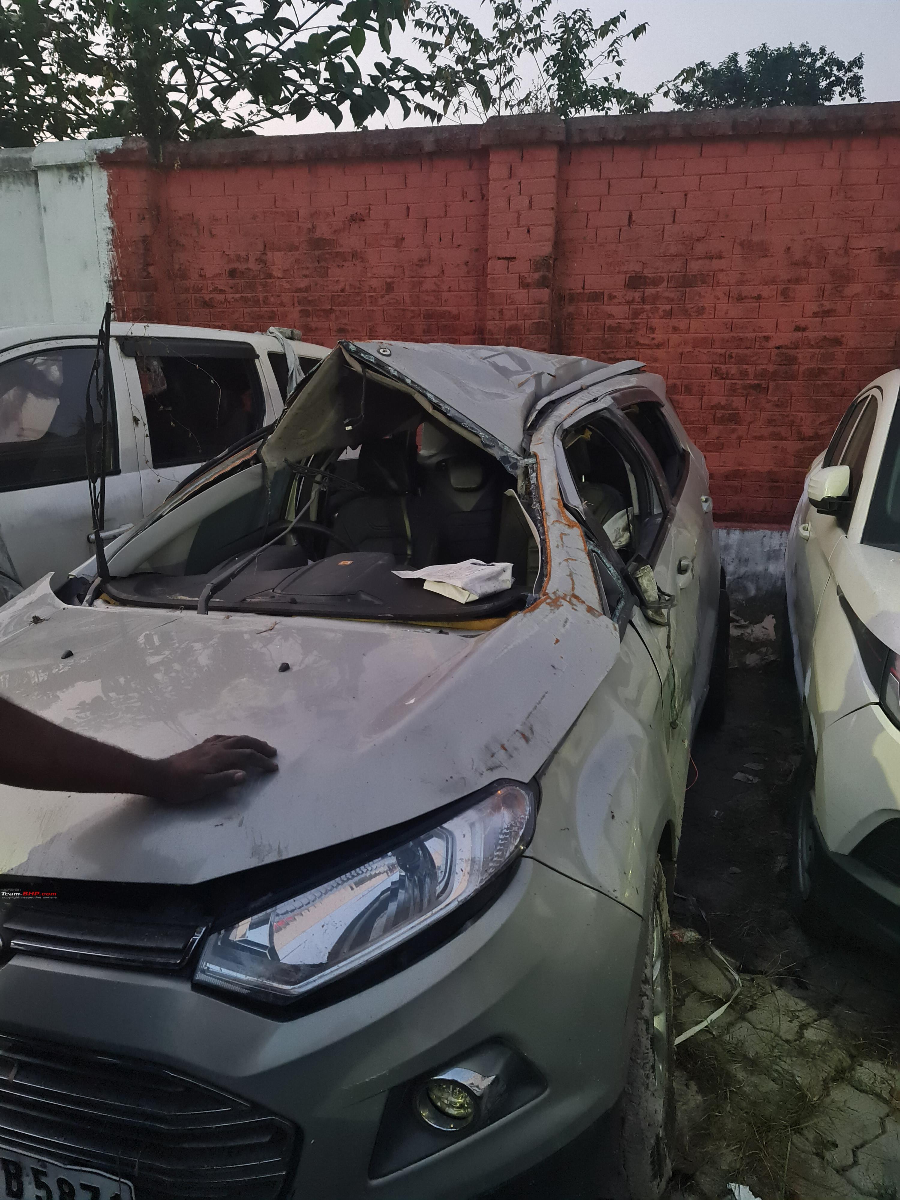

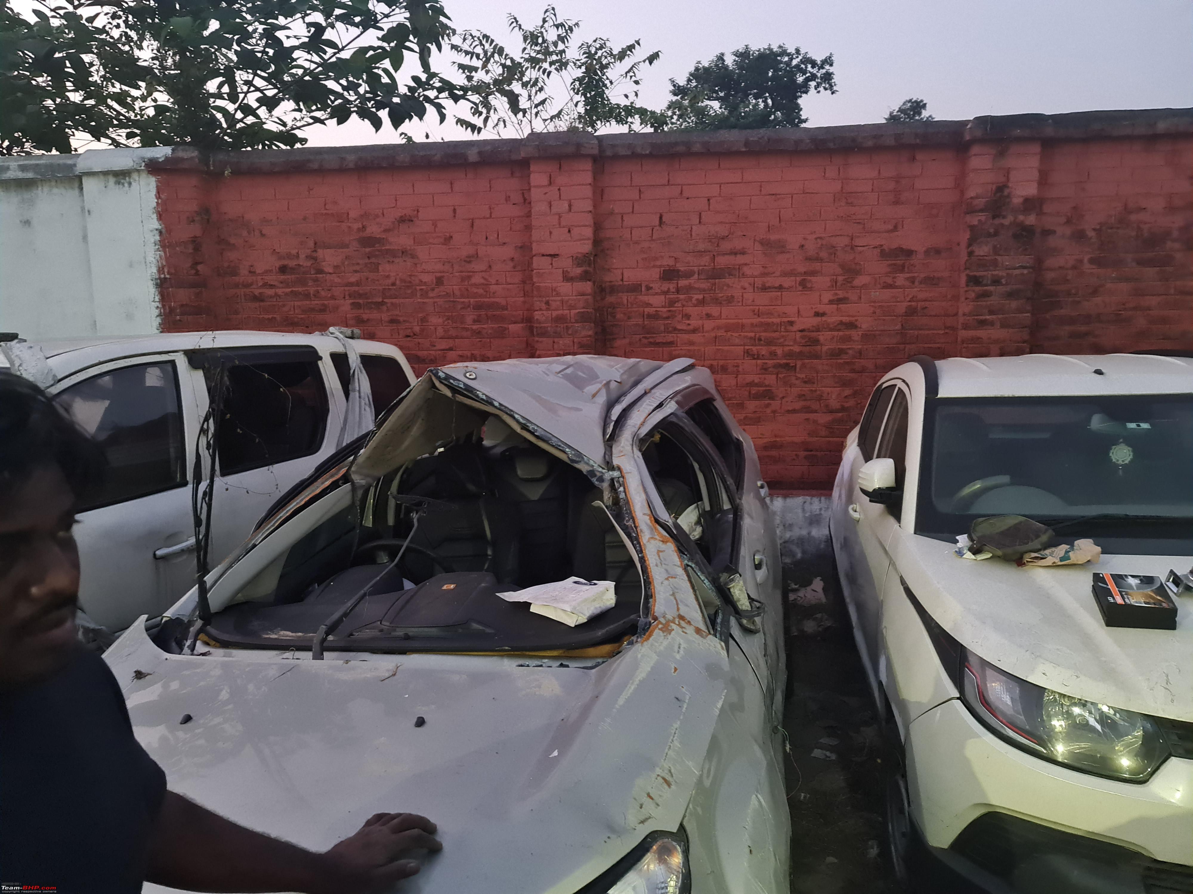

Hello, My name is Rahul and i belong from Kolkata. I am new to this forum and would be my first post here.
Unfortunately, i will not be able to start my journey in team-bhp on a happy note as i have recently lost my 2016 Ford Ecosport 1.5 tdci Titanium + in an almost fatal crash. Yet luckily, i lived. And lived to tell the story.
I would just write down what happened as things unfolded as i am still in a state of shock even after 1 month.
We were 3 friends returning from a marriage and the car was driven by my friend, while i was on the passenger side and one more friend on the rear seat. We were travelling around 80 kmph on a state by-pass road at around 3 am, when a Tata 407 came head on which made us serve left and off the road completely with all 4 wheels outside the road surface and almost into a roadside pond which was at least 4 feet lower than the road itself. Our car tilted left with left wheels touching the water, while still at 80 kmph, when my friend swerved right to get back up on the road but couldn't as the wheels couldn't grip. He kept on accelerating with the wheels spinning, hoping to bring the car up the road and avoiding getting submerged in the pond. The car was still probably at 80 kmph when suddenly the tyres gripped somehow and made the car jump up from the pond and on the road resulting in the car toppling on the left side and rolling atleast 8 times and hitting a light post and breaking a wall after hitting it and god knows what else. Finally the ordeal stopped, with the car plunging on another pond couple of hundred metres down the other side of the road, just giving enough time to get out before getting 80% submerged. Luckily it was 3-3:30 am in the morning and there was no traffic.
My car is a TDCI TITANIUM PLUS with 6 airbags and NOT A SINGLE AIRBAG DEPLOYED. NOT EVEN THE SIDE AND CURTAIN AIRBAGS. Yes, we were having our seat belts on.
The front windshield glass also shattered (on first impact with road) like cheap glass which it is not supposed to. The glass is supposed to be laminated from both sides as far as my knowledge goes, to prevent it from shattering and falling off and becoming like armed splinters(which is actually what happened and injured us, specially me with glass pierced on my whole body).
While the built quality of the car saved our lives with just bruises from the flying glass splinters, from the horrific accident, I'm still in awe as to how not a single airbag deployed.
Ford Workshop is giving lame excuses that the car was not hit from the front. WHAT HAPPENED TO THE SIDE SENSORS FORD? They said side gets activated after the front sensors are triggered which i found to be a lame answer. When i showed them a video on YouTube on Ecosport crash test from side with the side and curtains deployed, they didn't have an answer.
Before i take it with Ford, i thought of getting valuable inputs from this forum and getting myself armed sufficiently so as to not look like a fool when ford gives me another lame excuse.
I would now let the pictures do the talking.
Special mention for Ford RSA!
These guys are amazing. They kept in touch with me right from the time of the incident and kept me updated. They kept on trying to pull out the car for 2 days with multiple failed attempts and survey of the location, after which they finally did it after they brought in 2 Hydra cranes.
And lastly Kudos to HDFC Ergo!
They declared it a constructive total loss, handed over the legal documents for the same. No drama, no questions, they simply paid up. All from the comfort of my home. That's how easy it was. All within less than a month.

Very scary and unfortunate but glad that you are OK.
Airbags probably did not deploy because there was no frontal collision but I wonder why can't cars have sensors to detect rollovers.

Did the roof bend this way after the impact or while towing? Also the A-pillar has a visible bend. Did it happen during the accident?

That is a horrific crash and I am glad you all came out safely. Having seen Airbag ECU development from up close, unfortunately very few cars in the non-luxury segment have rollover sensing capability in the Airbag ECU.
Airbag sensors work on the principle of acceleration change and hence can detect the sudden deceleration of an impact to trigger the airbags. To detect a rollover you need a 'yaw rate' sensor which is part of high end Airbag ECU hardware and rarely seen in our everyday cars.
With your description of the accident, I'm trying to think if ESP would have played a role in preventing the rollover, as it sounds like a typical double lane change kind of a scenario at relatively high speed.

Glad to know that all of you are safe after this horrific incidence.
Just to add up to your apprehensions related to the glasses :
As per CMVR Requirement only the Front Windshield is supposed to be the Laminated Glass (i.e the glass with an intermittent layer of thin plastic sheet to avoid flying or shattering of glasses in the event of an impact).
The side glasses are allowed to be the Toughened ones (That means the side glasses need not have the intermittent laminated sheet).
Apex1815 is offline
Old 8th December 2021, 12:07   #15
veedub89's Avatar
Location: Chandigarh
Posts: 531
Thanked: 1,125 Times
Re: Ecosport toppled multiple times with none of the 6 airbags deployed
Good to know you and your friends are safe!
The side airbags deploy when there is a hit to the side of the body. The sensors for these side airbags are on the B-pillars (lower down) and on the side of the body and not say on the roof.
Your car has had very little damage to the sides. Only the roof is crumpled.
Most cars don't have rollover sensors either.
Combination of above two factors is why your side airbags didn't deploy.
As for the front airbags, there is hardly any hit on the front of the car. So again, no impact on the sensor so no airbag.
