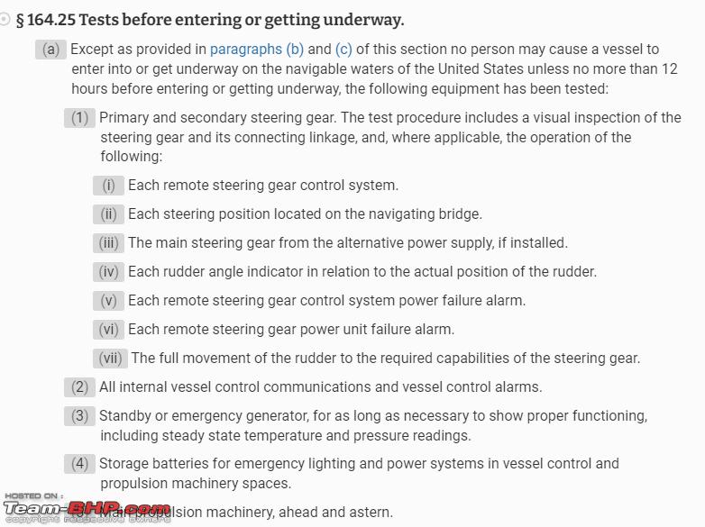

Originally Posted by kosjam View Post
So in my analysis of the crash video, the sequence of events was:
1. Initial black out due to fuel issues (sudden starvation of both generators due to common fuel filter choking)
2. Standby generator of equal capacity kicking in, evidenced by the lights coming on the first time.
3. A second blackout due to the same fuel filter issue plaguing the standby generator as well
4. The lights returning due to emergency generator coming on load.
In all probability above scenario is what is most likely to have occurred.
However, what is interesting to know is that the generators must have been operational throughout the port stay running on the same fuel and also during the initial phase of the outbound transit from the berth, so how come the sudden failure?
Did they change over the generators & fuel source during transit (unlikely)?
For those not familiar with visiting USA ports, compliance with CFR is mandatory and the USCG ensures the same. Following is an extract from 33CFR Reg 164.25:
Item No.3 above is very specific, so if it was indeed checked wonder what else could have gone wrong?
BlackBeard is offline   (1) Thanks
Attachment 2599017
Fuel systems are very dynamic in nature. Tanks are huge, and sometimes sludge which might have accumulated in a storage tank could get sucked into the fuel systems, causing the auto filters to clog up suddenly. A change in storage tanks under consumption is another possibility.
Regarding generators being operational throughout port stay, as I mentioned above, fuel is a dynamic component. Secondly, there is a possibility that the generators were not running in ports, and the vessel might have been drawing power from shore facilities. (I am not on container ships, so would not be able to give specifics on this.)
Filters are generally built to manage a certain degree of sudden sludge influx, but there have been multiple instances of excessive sludge overwhelming systems.
Regarding the standby and emergency generators, they are tested, all parameters confirmed normal, and are stopped and put back on standby. They do not continuously run.
It could really be a really bad case of SHIT HAPPENS. If this is really what did happen, then it was their supreme bad luck, to say the least.
Hope that clarifies things.
Last edited by kosjam : 25th April 2024 at 19:28. Reason: error correction post proof reading
kosjam is offline   (1) Thanks
