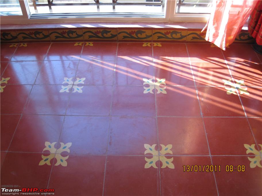

3. Re use doors and windows from old buildings - this is self explanatory.
4. Atthangudi tiles - These are hand made in the Chettinad region of Tamilnadu apart from providing employment to rural artisans they also are very low in energy consumption and also keep the home cooler in summers.

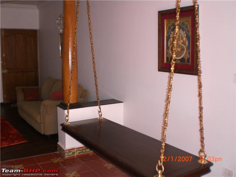

Some pictures: My way of going green
1. Atthangudi tiles
2. A reclaimed teakwood cane sofa
3. An old swing
4. Reclaimed wooden flooring
5. A pair of old reclaimed pillars and a beam
6. A rosewood crockery cupboard made from 2 old cupboards
7. Atthangudi flooring, old 4 poster bed, old dressing table, old writing table and a laundry box

1. Attangudi tiles are a great natural replacement. These tiles are hand made, and as such very low on energy usage. Vitrified tiles on the other hand are very high on energy consumption (while manufacturing).
However, Tiles are a much debated topic, so my personal feeling is that one should go for what one likes.
