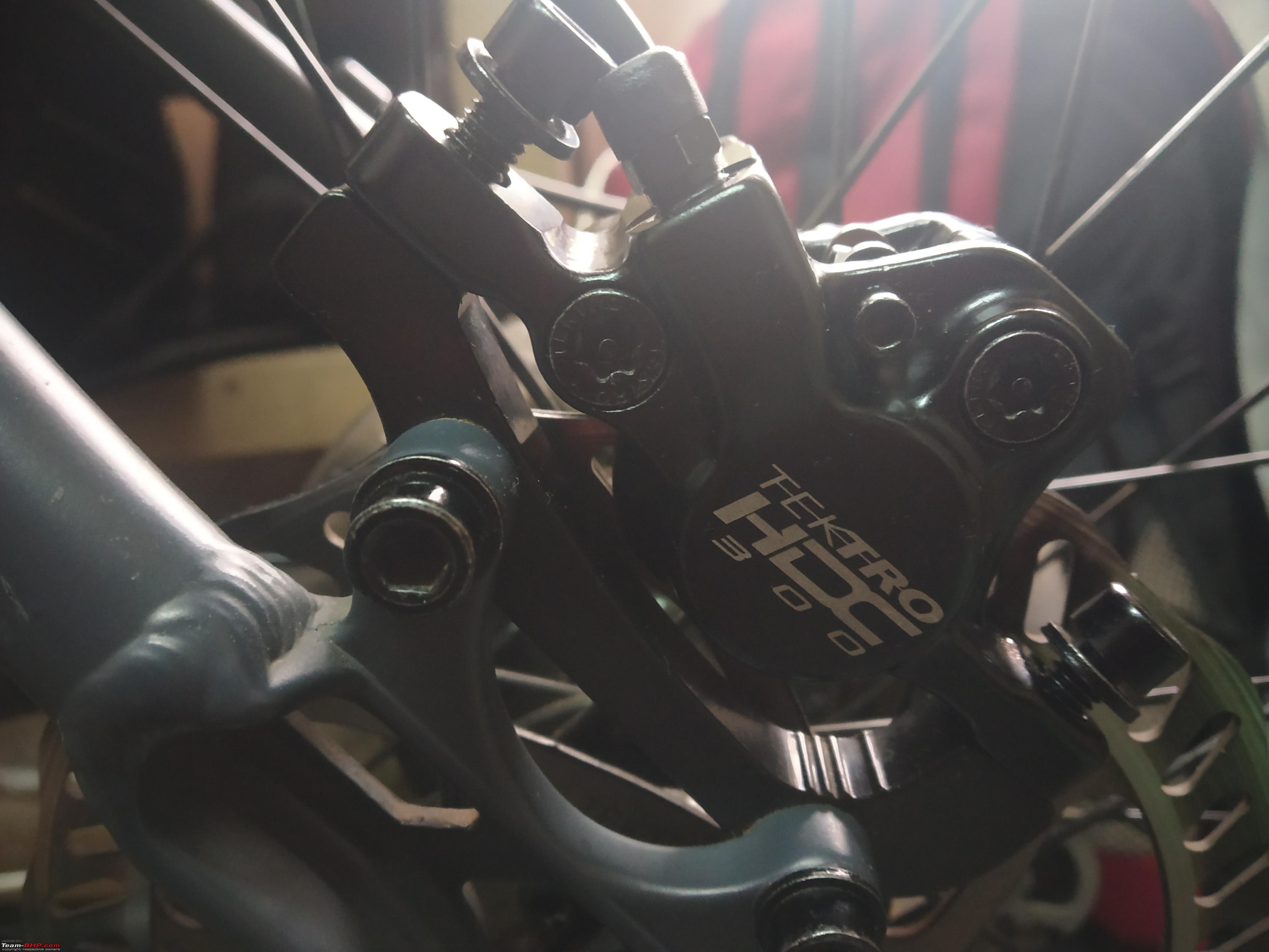

The caliper with the 5 mm allen bolts removed and caliper carrier.

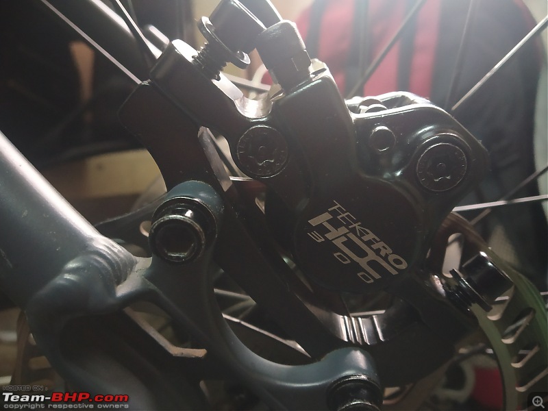

The innards of the caliper. Truly surprised by the condition it was at. Though, you can see rust formation on the lip of the caliper piston.

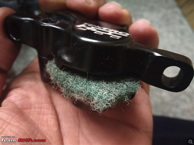

Now, with the pads sanded. Next step was to clean the pad springs, caliper innards and pistons. I did use a Scotchbrite scrubber to clean it. This scrubber is stubborn yet is soft on the caliper's superbly finished aluminum housing. Cleans mucks very neatly, with the help of brake cleaner. No scratches!
Some brake cleaner and brushing the innards of the caliper.
Scotch-brushing the caliper. They come out great!
