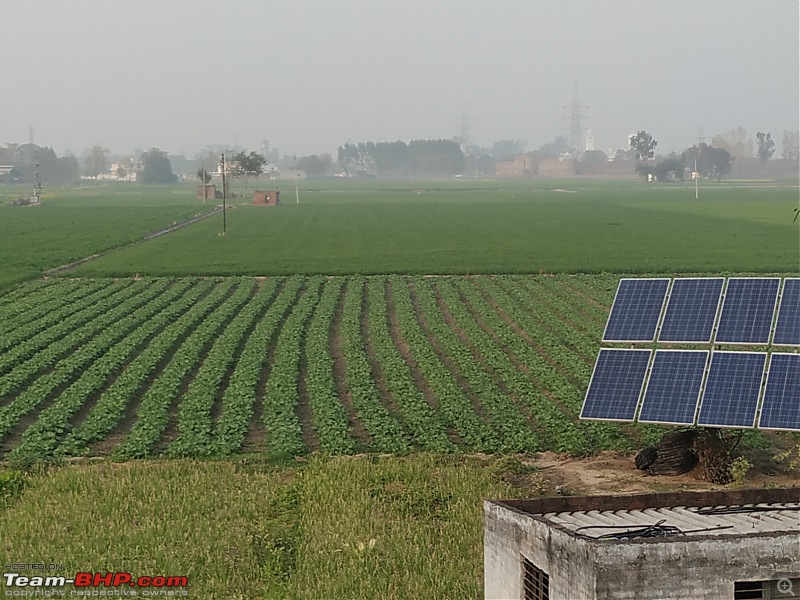

If you visit your farm and speak to neighbours you will probably get good answer to your questions. But before you dig, few things you must answer for yourself.
Is groundwater absolutely necessary. Amount of rainfall in your area and possibility of harvesting runoff. You get get upto 90 percent Govt subsidy for it. Speak to Dept of Soil and water conservation in your block.
Whole of country has been mapped about the water quality, depth and terrain. In your area the above mentioned dept will give you the details.
Sink the borewell or build a check dam or dig a tank based on natural lie of the land so the water flows as per gradient otherwise you will use energy to push water
Lastly, power connections for borewell are not being encouraged/ permitted especially for arid and semi arid zones, consider solar it's reliable and cheaper for the pumping unit for the borewell or tank. Govt support under project KUSUM is available.
If new to farming do consider adopting permaculture / natural farming techniques if the area is less than 5 acres, it obiviates the need for water to a great extent. Or consider integrating with drip, A 5hp motor comfortably irrigates my 6 acres on commercial cropping with drip.

On the other side if you can avail solar energy, then there is nothing like it.
11- If you are going to go to your farmhouse only on weekends and if you do not have a caretaker it is a bad thing for the Plants as they will require water daily especially during summer for the first 6-8 years. Do not worry there is another technical solution to this.
Connect all your plants with drip irrigation pipes and this drip pipe shall be connected to your bore output pipe. There are auto on/off switches available for bore motor which can be activated by mobile app(Costlier one) also there are programmable auto switches(Economical ones) available in which based on electricity availability, the switch turns on automatically for programmed amount of time daily. Thus automatically watering your plants.
12- If hard water encountered, you have to take a few treatment steps, as hard water though is okay for coconut plants, it is not good for other fruiting plants. We have hard water and our Mango, Chikkoo, Custardapple plant suffered initially, my uncle suggested adding some type of gypsum compound to the borewell and post that the water quality has improved(yet I don't know what were the technical details of the stuff added as the job was done by my uncle and father)
Adding image of my farm and farmhouse as a motivation, we began all this in 2015 and after 6 years it feels like heaven! hence all the pain efforts and money is worth!
