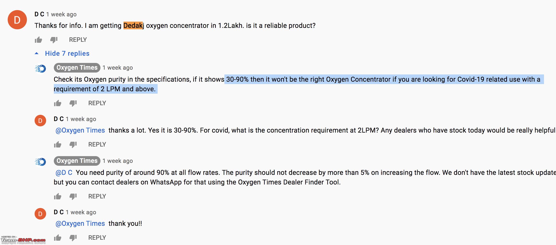

Spoke to a chennai dealer today and got details about two models. Both are them are not fit for Covid. Sharing here so that others can also be aware of the specs when they come across these models.
MODEL 1 - DEEDAKJ DE-1A @ 1.2 lakhs
Brand name : DEEDAK J
Model number : DE-1A
Price : 1.2 Lakhs
LPM : Upto 7 LPM
Oxygen Concentration : 90% at 1LPM
Weight : 6KG
Fit for covid : No. For covid we need minimum 93% at 5LPM
Pics of the device attached below

The below two screens will tell the O2 purity/concentration is at 45% when LPM is at 9. Took screenshots from the video shared by the dealer over whatsapp.
ps- Looking at the incident in Andra makes me feel we should either have a spare cylinder or have one such machine at our hand for safety even if we get hospitalised. Whoever had spare cylinder survived that incident. The oxygen truck from chennai sriperambudhur got delayed by 2 hours resulting in that incident. I hope they DONT arrest the truck driver or do something like that. Usually the last guy in the line gets axed in our country.
Having a concentrator seems like a good bet. But finding the right product like Nidek which can give 10LPM at 93% purity is getting very rare. If anyone comes across the right device please share here.

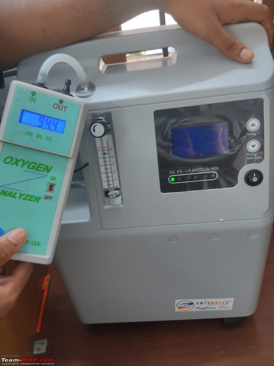

The last few days have been a roller coaster ride as my father-in-law got admitted to a hospital in Madurai need of oxygen support. The hospital too was arranging cylinders on a day-to-day basis and the situation seemed very dire 2 days ago. That's when I browsed this thread one more time to find the right details and decided to get an oxygen concentrator (if oxygen situation in the hospital becomes too bad) for my father-in-law.
He was needing 6LPM to maintain his SpO2 concentration at ~90%. As he removes mask for few minutes, his Sp02 level dropped to ~50%. This basically meant that he can make use of (RIGHT!) oxygen concentrator instead of depending on cylinders, if at all the hospital runs out of supply or not able to get supply on time. Based on the collective inputs from this thread, I have spoken to a lot of dealers and tech support and I was disappointed that more than 60% of medical suppliers I spoke do not know this difference. Some of them were suggesting the oxygen concentrators used for Sleep apnea and COPD conditions, which is clearly not usable. So I started digging deeply and found a brand from Chennai, which matched all the specs mentioned by lemedico (You should know you are a life saver! ). Ordered 2 nos. of 5LPM and a cousin of mine transported it from Chennai to Madurai and reached yesterday morning. The reason to 2 get 2 nos. of 5LPM is because 10LPM is literally not available anywhere and this particular brand had only 5LPM in stock. The biomedical engineer there showed it is possible to supply upto 10LPM with a Y-connector.
From yesterday afternoon, my father-in-law is getting 6LPM oxygen from these 2 oxygen concentrators and 1 type D cylinder is in standby for his emergency support, if the machine fails. I am actually very happy that the hospital situation has improved now and because of the 6LPM saved for 1 patient, the hospital can use my father-in-law's quota to someone else. No words to explain the peace of mind to my wife's family.
This is the one I bought. https://entrusted.in/buy-online/ols/...uilt-nebulizer
It was on stock until yesterday and it seems to be over now unfortunatley. But they also bringing quite a lot of stock in. Also check their website frequently, as they are very professional in transactions, maintaining their stock status online and supplying pan India through courier. Best is to whatsapp than to call. They also seem to have provided to hospitals, railways etc. I am in no way related to them. My need for how to use 2nos. of 5LPM concentrators to supply 10LPM landed me in their youtube video:
Their channel has very useful instruction videos of almost all their machines:
https://www.youtube.com/channel/UCu1...Vkt81NjJuaFClw
We bought 2 units and both of them measured 94.4% concentration at maximum flow rate:

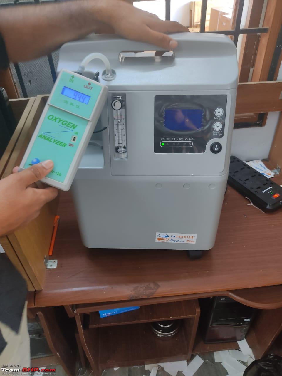

Is it something practically possible to build an oxygen concentrator at home? Is there a bottle neck to do so? Say, by using a small start up team who know a thing or two about how stuffs works. I didn't mean entirely make at home. Say if we can have access to some electronics/electrical lab set up as well. Anyone knows the technical architecture of it?
Disclaimer: This is not for any profit making, but to just help ourselves.
Yes, possible to DIY.
I have built this machine using locally available off the shelf parts.
