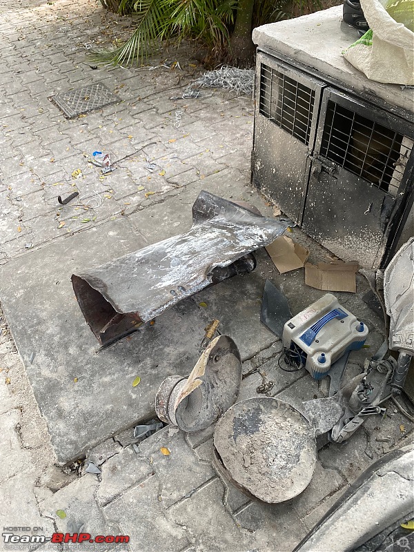

What cause the explosion?
The 19 year old youth was actually filling balloons from a cylinder canister. One thinks it is helium but it is not. It is a crude mix of aluminium powder, calcium hydroxide or something like that to produce something like acetylene. My security person told me that they were initially working in the apartment. He took the cylinder out and kept adding more chemicals to generate gas. The cylinder had the properties of a rusty milk can and exploded. The blast threw the boy against the tree and then half under the Mini. The cars were spattered with some calcite substance.
This was tragic but could have been worse
  • Our security guy had popped inside for something and was coming out, he was covered with the powder and had light burns
  • One 80 year old neighbour just walked in and had settled down to watch TV. If he had been 5 min later, the canister could have exploded ion him and the shock would have got him.
  • The only child in the apartment regularly cycles in front.
  • The gas generated did not inflame, the explosion was caused b the structural failure of the can
  • The casualty rate would have been much higher had the explosion happened inside the apartment

The remnants of the canister and the other equipment. All this was removed as evidence.
Balloon Party gone wrong | Balloon cylinder explodes in my housing complex, 1 fatality-img_2003.jpeg
