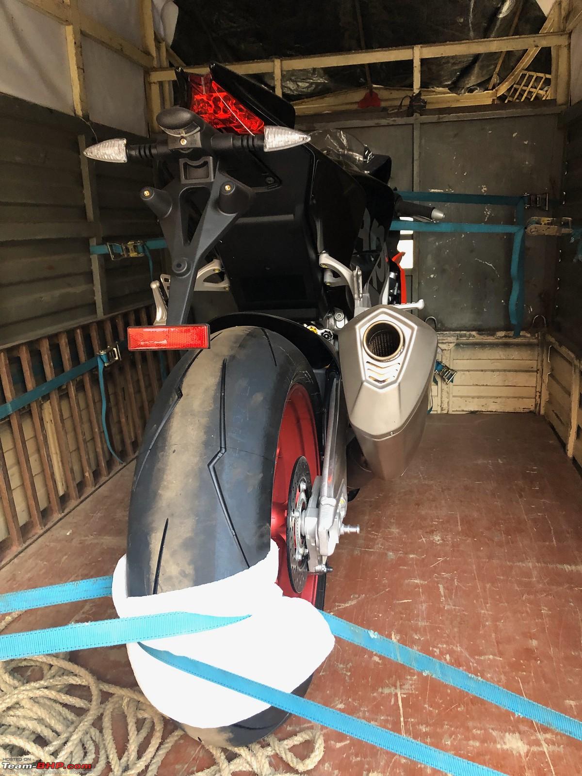

Getting the bike delivered

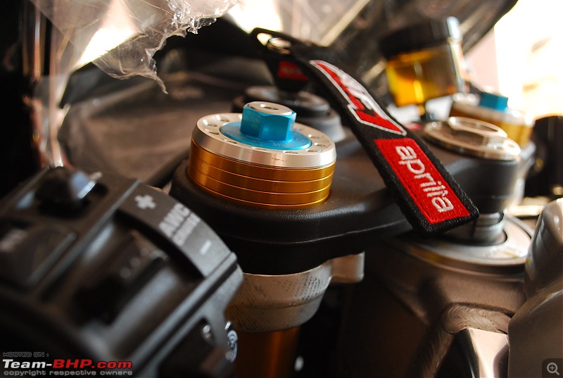

Compression adjustment on one fork leg
Rebound adjustment in the other

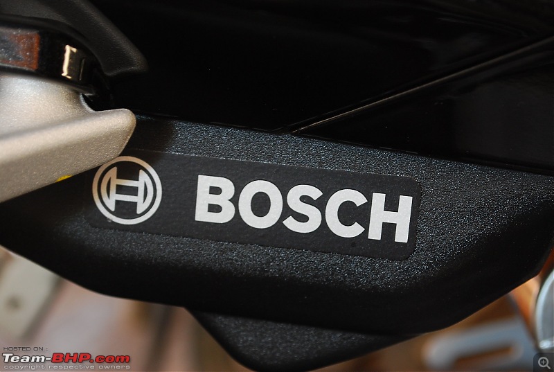

ABS unit provided by Bosch

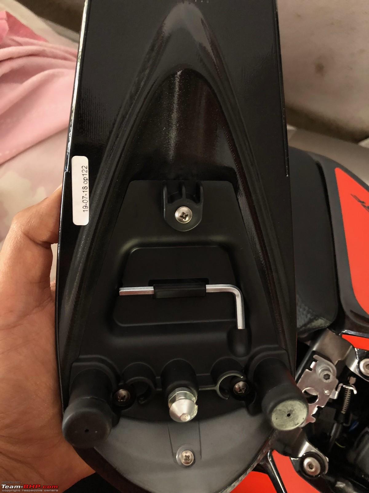

Allenkey for removing the rider's seat

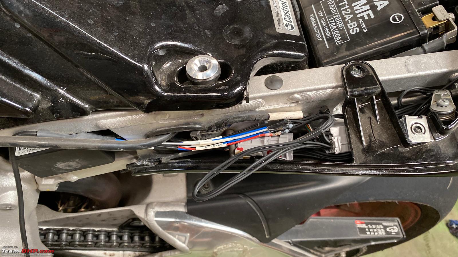

Y-cable for AIM data logging
Tucked in neatly on the left side of the bike
This end goes to the AIM unit

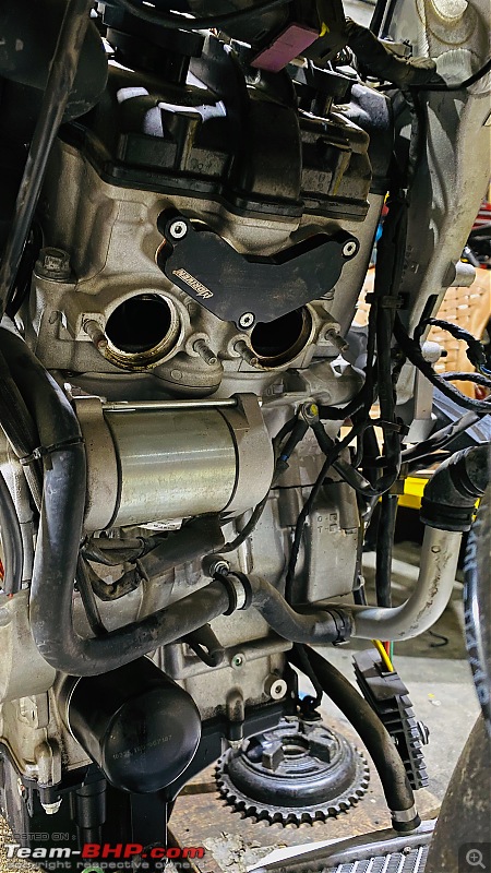

OE front bank headers
Front bank minus headers, you can see the exhaust servo unit with the cables to the left
