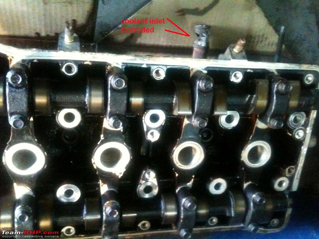

Hi All,
thanks for all your help so far. A quick update
The issue is with only the valves and coolant inlet pipe. While opening the head, this was discovered:
1.) Valves are stuck. Mostly a bent valve/valves
2.) The coolant inlet pipe that goes into the head corroded leading to Coolant evaporation hence causing this damage
3.) Pistons, Cylinder etc are all fine....its only the valves. The gasket also seemed fine but will replace that and timing belt, fan belt, oil, oil filter etc anyways
Thanks so much guys...will keep you all updated

Hello Guys,
UPDATE: The car came back home last night at 11pm.
1.) Two valves got bent leading to all this
