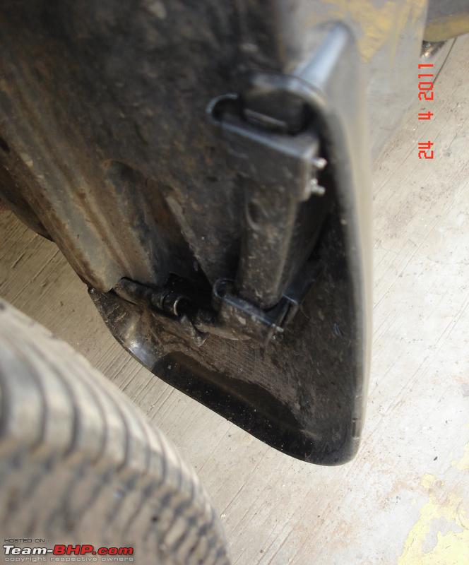

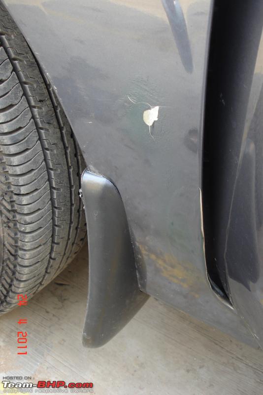

Fair enough (he is a neighbour and a friend after all, thought I), got my camera out.
And this is what I saw:
Opened the bonnet. Asked him to start the engine. And like a bloodhound smelt around. No out of the ordinary smells assailed my olfactory senses from the engine bay. Electricals fine. Checked the left indicator lamp connections. All well. Noticed high air intake point.

Started all over again. Looked around everything looked fine. Except for the spot where the fire was reported.
Asked him to piece together his return journey right from the previous days activities. Asked him to keep the gory details of the family bonding out and stick only to the vehicle related details - lest he got carried away.
What finally emerged was that on the previous day while driving around the Goan country side the front left mud flap assembly had been damaged after the left wheel went into a ditch with stones. It was torn apart and left a gaping gap between the metal body and the well liner.
Inside this is a hard sponge insert which was found completely burnt.
And then asked him about the route etc on the day of the return. Transpired that he had travelled on small village roads near brick kilns where there could have been careless wood/coal embers left around. And later on travelled on to a section where heavy tarring and general road repairs were on.

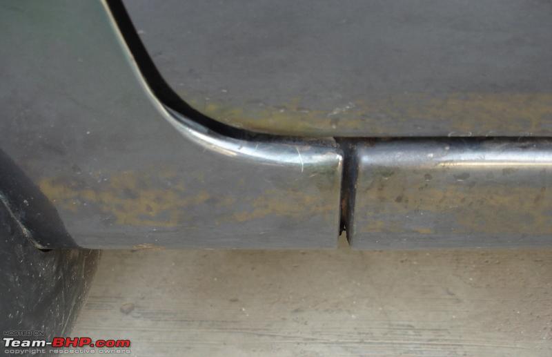

Also noticed, between the front left open door and front left panel - where there is a gap, a lot of detritus and dry leaves. Partly burnt.
And I surmised as follows:
1. Previous day the bloke damages his mud flap. Leaving a large gap between the body and the plastic liner of the front left wheel well.
2. Next day morning while returning to Pune he goes over a couple of spots where there could have been burning embers left behind by the road tarring crew or the brick kiln workers and one of the pieces is thrown up by the tyre and into the gap where it lodges securely between the metal body and the hard sponge insert. The sponge (which should have been of a fire retardant variety or was it ?) slowly starts to smoulder and soon enough the well's plastic liner catches fire.
(Examined the tyres - they seemed to be free of damage which should have been caused by the embers when they went over them.)
3. Luckily for him the onlookers saw the smoke n fire and alerted him.

wow freak incident. Can we please get pics if possible with the fender removed. The Ford guys will do this first.
The mud flaps are prone to breaking off very easily.
Hi Vid, Thanks. The car drove back to Pune last night. Have asked my friend to take a snap of the gap when the fender/liners are removed and if he gets one - shall post it here.
