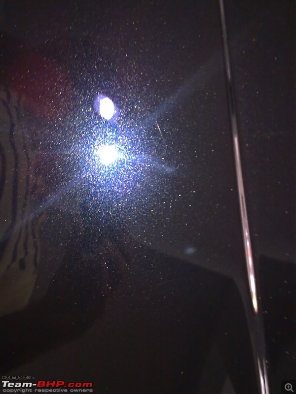

A friends black ikon- a dream for a DA project, was the object of our attempts today.
Tried out SwirlX- hoping against hope that it works, but it did not even make a dent on the heavy swirls that sit on the car(5 years old now)
Took out the heavy artillery- UC and ran a pass. Superb! Ran another pass and Magic happened
It took 4 hours just to cover half the car. UC is a one step solution IMO. Just let the DA run over it again and again, it breaks the compound down and once the surface clears up, stop and inspect. Some parts we needed a second pass also.
I have just put a pic of a section before and after- the results are amazing.
Ford older paints are soft and ideal of a pass of Megs UC. On my city, UC took longer to break down and take effect( harder paint)
Will post pics of the car once all is done too, its a dream project for sure( black and that too heavily swirled!!!)- Better and more pics to come!
Section before a pass with the DA

btw regarding the ikon, you just did 2 passes with UC and it all cleared up!?(did you feel a need for a final polish?)
MKH - The results on the Ikon are amazing & your ANHC looks even better than a show car ! The finish is looking wetter, deep & glossy ! The Pinnacle you have will make it even better im sure !

Yeah- its all due to Nirmals DA- one that really "flexes" your muscles;)
Clearly the last pass with SwirlX( after 105, UC on diff panels) made the surface much better to reflect BFWD. The last time there were about 5-6 layers of BFWD but this effect did not come, now with 3 layers, can be seen. Its really a joy to see this in the night light!
Will apply pinnacle when the rains stop here
On the ikon- just did UC, some places 1 round, some places 2passes. Worked on an area slowly and till the compound cleared up( and it takes a while) and moved on. It cleared up easily- no haze, not much to wipe off too. UC has been a joy to work with in terms of the ease by which it clears up in this experience.
