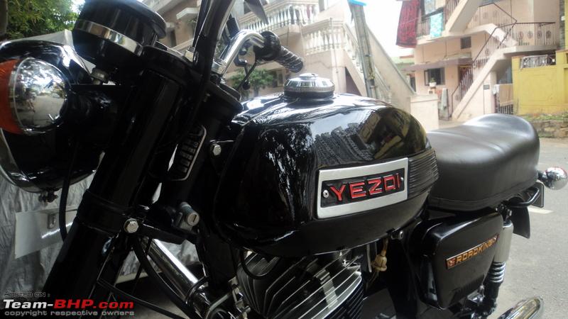

Here are the results of Meg tech wax on my bike after 6 months(Last detailing done on it). Spent almost 3 hours and was very happy about the results of the time spent.
Detail gurus, your comments and suggestions please.

Also, i found small round rusting marks on the rims of the bike. What is the solution to avoid it. Suggestions please

- Nice effect ! Good work with the NXT ! Not sure from the pictures whether you have applied tire shine, if not then that would make the tires stand out too !
For the rust on the rims, try cleaning them up with clay bar & applying NXT to seal them ! If you have a dedicated chrome polish like Megs All Metal Polysh, then you can try that too !
