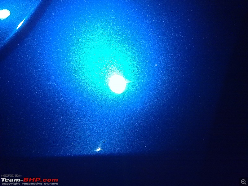

Got a lil time today to finish polish my i20's front bumper!
I didnt feel like taking the DA out(kinda feeling lazy lol)
So did all the polishing by hand with a orange hand pad.
I'm glad to say that I was able to achieve a swirl free finish just with hand polishing!! :D
(btw this bumper(this is repainted one) had loads of orange peel that I had to wetsand with 1500 > 2000 > 3000grit papers to level out the finish and then compound with M105 and a wool pad on the rotary polisher to make it look presentable!)
But I left it after compounding as I thought that while fitting the bumper on the car, some minor scratches and marring will be inevitable and I'd finish polish it after its on the car.
So today I got the chance and set about it with hand and I was really impressed! (The reason I was able to remove swirls by hand is partly due to the fact that buffer swirls are quite shallow unlike regular swirls that are relatively deeper!(and thus difficult to remove)
Some after pics -

@sohail,
You just did the polish now. Which Polish? How long did it take to finish just the bumper by hand.
@sohail: Wont Meguiar's UC or scratch x 2.0 remove swirl marks when applied by hand? I tried using them after claying. After wiping off UC using a MF cloth, I was not able to see any swirls. Then I applied techwax 2.0. I was able to see some swirls (the swirls had improved after UC application). Any ideas why this is happening?
Though sohail can answer, but based on my experience- you CANNOT remove swirls by hand, only hide them. Immediately after applying you cannot see, that also depends on if you saw with naked eye or under swirl finding light.
Mild ones maybe possible to remove to some extent, but most of them, hand application cannot remove.
^The applicator pad might have picked up contaminants while you were applying techwax.
Usually after I'm done polishing and break out the wax, there's already a very fine layer of dust over the just polished surface(not much apparent in light colored vehicles or at night)
For this I have to gently touch the microfiber to the paint so that teh towel holds all the dust and then immediately after final inspection of the panel and the applicator pad I get down to waxing!
Sometimes if there's constant downpour of dust(which is what usually happens), after doing one section of the panel you've to re-dust the other section you're gonna wax and then apply wax to that section after final inspection of both panel and the applicator pad!
Its literally kinda like a battle against nature, that we car care enthusiasts are always waging! lol (I HATE DUST to the core!!!)
Megs UX, scratchX and SwirlX will remove defects by hand but that depends on the severity of the defects itself. If swirls and scratches are mild then hand polishing 'might' work great(I said 'might' as there are other factors at play here like even though there are a few swirls on the panel, we don't know the depth of them!)
The relatively deeper ones might need a polisher, it's much much easier with a machine!
I usually go about tackling smaller areas by hand so that I can concentrate and evenly polish that area, then after the polish dries up I spray some quick detailer on the applicator pad and work the same area again until it dries again. This works at least on my paint!
You can try this, but usually you've to find out what combination works best for your paint!
@rkSans - It took about 2 hours lol! :uncontrol (thats partly cuz i20's front bumper has a lot of crevices and recessed portions, like the area around the foglamps, the thin fold around the front air dam etc.)
I used the sample of the least abrasive polish that I had, wolfgang finishing glaze.
Btw I would've achieved the same results with Meguiars SwirlX :)
