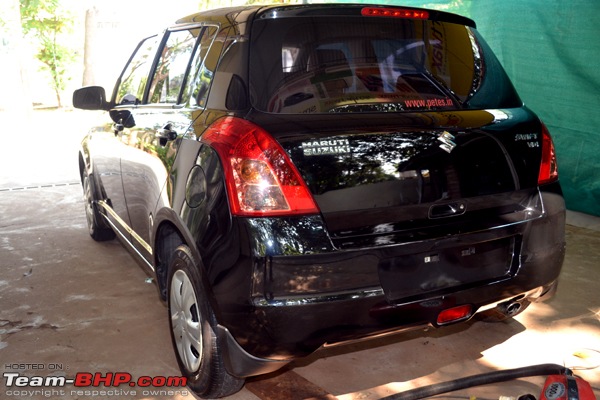

This is just a typical example.

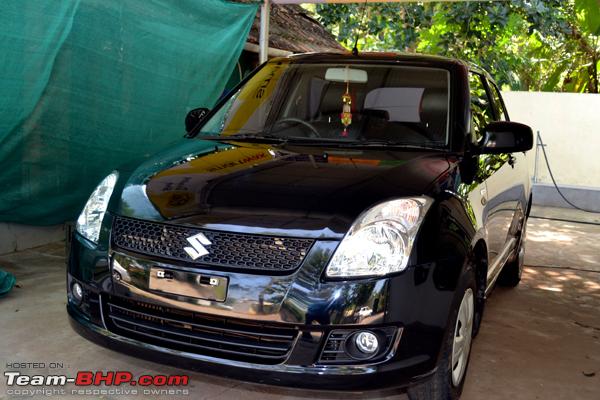

A superb Car cleaning, polishing & detailing guide-swift-2.jpg:D
With the final coat of wax prior to it being wiped off. I usually leave it overnight.
The result as seen from the rear.
