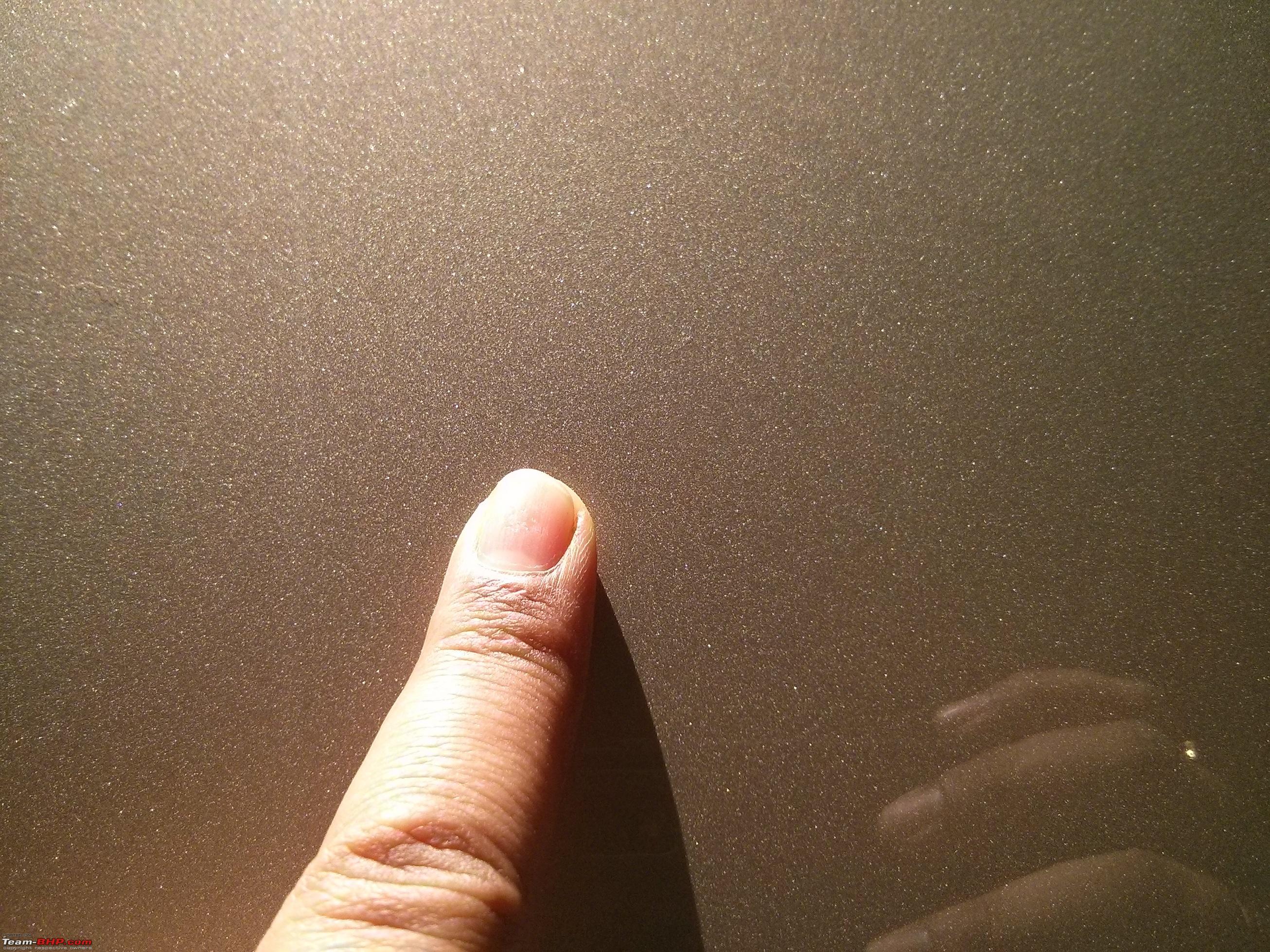

CarPro REFLECT
Wanted a new tech finishing polish. After a short search and review of Autogeek and Detailing World forums, decided that CarPro Reflect should be the one i should buy.
Placed an order with Ultimate Detailerz and was delivered quick a few weeks ago. Got to try it only last weekend. Used it with a grey/black LC pad with rotary @ 1000 RPM. And i was very impressed with the result.
Reflect was able to remove the minor swirls easily. But what impressed me most are 3 things
1. The ability to make the flake pop - This polish brings out the metallic flakes from the paint and makes the paint look like a million bucks :)
2. Quantity required - No need to prime the pad. Just four small drops the first time and 3 after that for every section. Can do 10 cars of i20 size with a bottle.
3. Working time - Unlike other finishing Polish which have a long work time which aids jeweling, Reflect has a short work time. The polish being a DAT(Diminishing Abrasive Technology) will need to be worked to break down the abrasives.However the polish breaks down in 4-5 panel passes. Wiping off is easy peasy and wipes off without any effort! No Dusting also!
Few pics

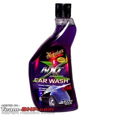

Dear All,
Over the last so many years I have used quite a many different car products. Recently, I was using Maguiars Car shampoo. Frankly speaking I was not so happy with the outcome and also wanted to try something else. So, had a plan to try out Wurth's shampoo, I was about to buy it but then I came across Jopasu Car shampoo. The brand name was very well versed but not all the product as such. Till date I knew only couple of products from Jopasu which were Jopasu Car duster and glass cleaner. I was really impressed with the outcome of both these products. Hence this time decided to try Jopasu Shampoo. So, went ahead bought Jopasu Wash n Wax Shapoo.
I am using this shampoo from last 1 month on my car and bikes and I must admit that I am really impressed by this product. My observations are as follows,
- It doesnt leave any kind of residue on the glass
- Generates lot of foam which is really good
- Smells nice
- Does clean the dirt very well
- it also leave fine wax coating kind of a thing on the surface
- Even small quantity does wonders
- Very well priced
For more information please visit following website
http://www.jopasu.com/products.html#...lity-Product-U
