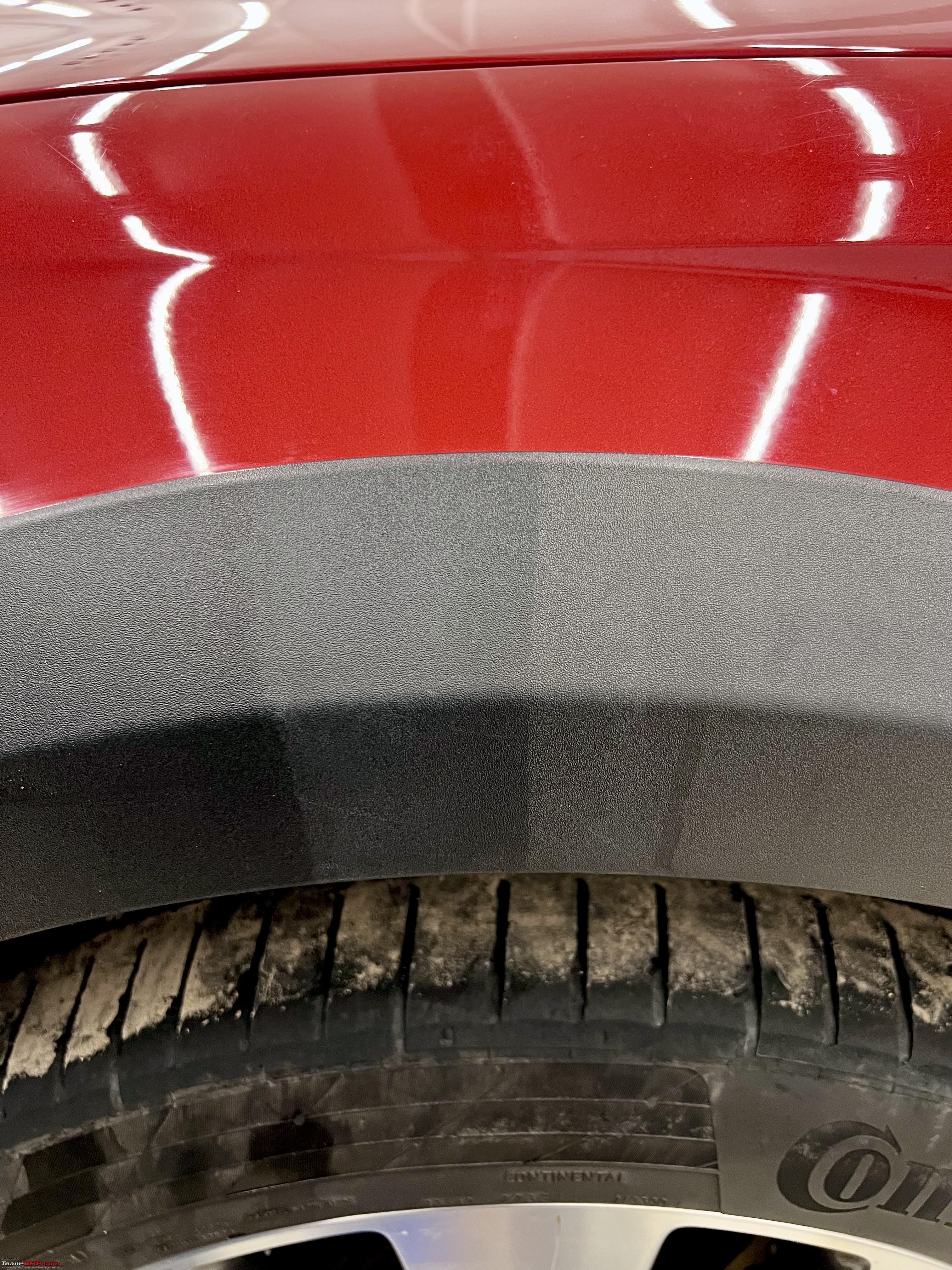

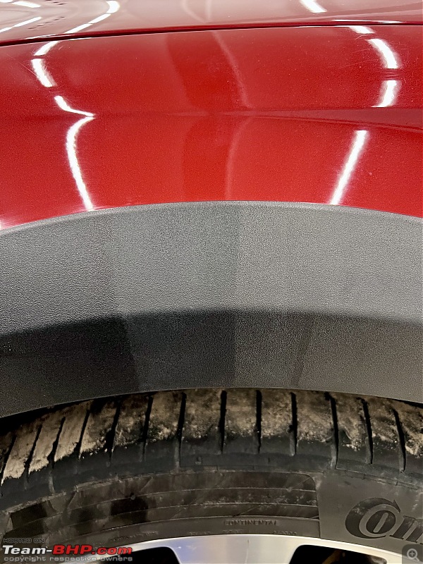

PERL is one of the longest lasting silica based trim and tyre dressings one can use, outperforms Darkside every time I’ve tested. Use it neat, no dilution.
Also, how long a trim dressing will last depends very heavily on your surface prep, if you car is anything over a few days old, chances are the plastic trim is already contaminated and looks white/faded due to surface mineral deposits and oxidation.
To deep clean, simply remove dust and use a concentrated all purpose cleaner (APC) and agitate with a medium stiffness detail brush, you may have to repeat a second or third time as textured plastics can require some agitation to get everything off.
25% IPA wipe to degrease and now you can apply PERL or your dressing of choice.
Will also clarify that a trim dressing is what most of these products are, trim restorer seems to imply something that’s at least semi permanent and won’t wash off easily, whereas trim dressings will (including PERL) if you apply over a surface that’s isn’t very clean and contaminant free to begin with.
Ceramic coatings for plastic trim do have a slightly longer life but again, if applied over anything short of surgically clean plastic, in a few weeks it’ll go back to turning white (just like rust, all of it needs to be off before sealing.)
I personally avoid ceramic trim/plastic coatings as in certain cases they can react with the trim and leave permanent discolouration (old BMW’s in particular). They are also irreversible, in that if you leave a high spot or botch the application in any way, you can’t use abrasives to fix and strip the coating as it’s a matte textured plastic with dye and using a polish or compound will cause further discolouration and mess the texture up.
If you have actual damage/discolouration on plastic trim, there are industrial dyes available and these are the only product category I would classify as a ‘restorer’ as they won’t wash off.
The shot below shows untreated, contaminated plastic (right), clean but unprotected plastic (centre), and clean and dressed plastic (left).
Many people skip the cleaning and degreasing step and go straight to application after a wash, this approach ensures the dressing cannot bond to the surface properly and its durability goes for a toss.
