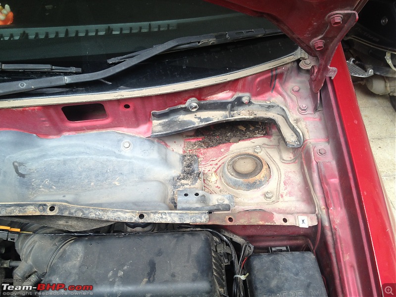

As mentioned by @Fullrevs, if you remove the plastic cladding on the navigator side (you have to open the bonnet to access it IIRC), you will see a hole where you can put your fingers and remove any leaves and dirt that blocks the water drain hole.
I have sold off that car and it is not with me anymore to snap the pics from my car. I found a suitable image from internet and marked the area if that helps.

Mohan41 and Fullrevs, I would like to thank both of you for helping me out here. I have for the benefit of any future reader, putting pictures of what i found and the post cleaned up pictures.
I am glad I could do it myself. On another note, is it a fair expectation that when you give your car for servicing, the service centre should clean this area ?
I found accumulated mud/dust of a long time.
I have posted pictures.
