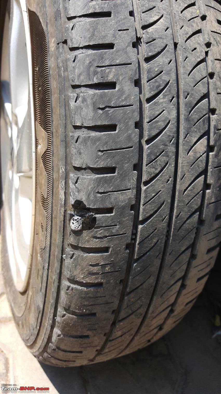

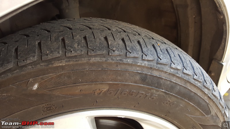

I've attached the pics, the depth of the tread doesn't look that confidence inspiring at highway speeds. Also the tyre guy mentioned that the front tyres have gone weak at the sides and atleast the front two tyres need replacement. I'm inclined to switch to Michelin XM2 tyres (Stock size 175/65/R15 and i've found them to be very adequate in terms of grip, comfort and efficiency for speeds upto 120 kmph max)
If you notice the last pic (front_right tyre 1), you'll see a wet patch with bubbles. This is the place that had a puncture (no nail but it appeared like perforations) The puncture guy patched it obviously without hitting the puncture spot so the leak remained. It was patched the second time and the today i noticed (bubbles as seen in the picture) the puncture is still there and I don't think it can be fixed by patching from outside anymore. Any suggestions / ideas. Would a mushroom patch from inside fix this problem ?
Sir, I don't think you should be taking this car on highways anymore with these tyres!
Thread depth is near to changing stages and the patches of repair aren't done well either. These weak patches give way sitting highway drives as temperature and pressure inside increases so the easiest link will give way. Not safe IMO.
I'll suggest you to change to Michelin XM2 as soon as possible. I am using the same tyre now in my Swift. I too graduated from MRF ZVTV (185/65 R15). I upgraded to 195/60 R15 when I got the XM2. I am not sure if your Honda can take 195/60 R15. If it's not an overkill, do get these. Excellent in all terms and I am very happy with these.
