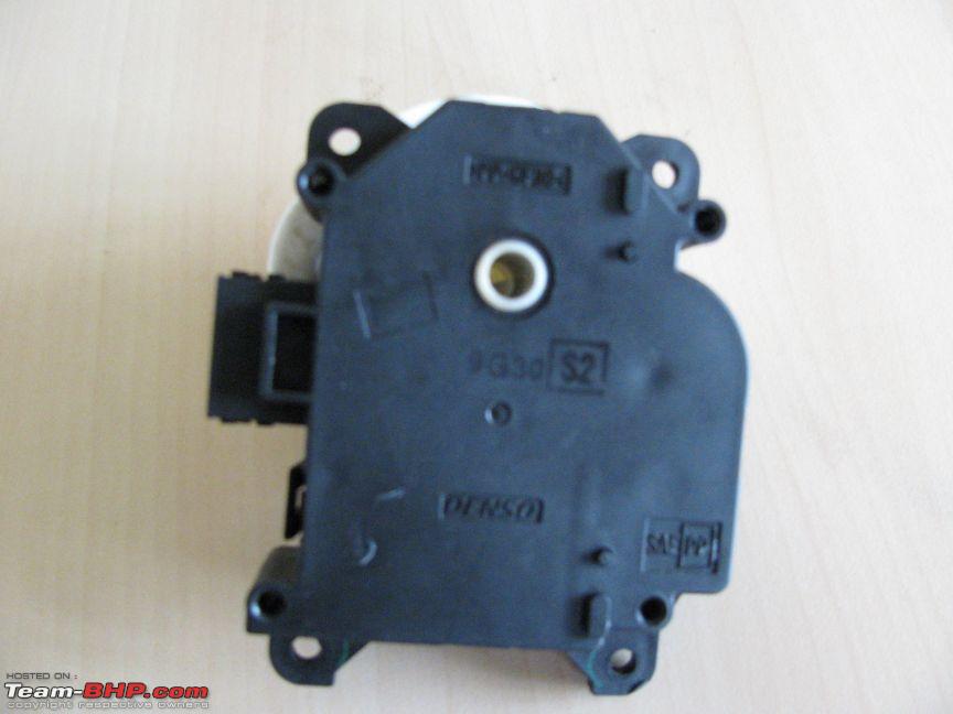

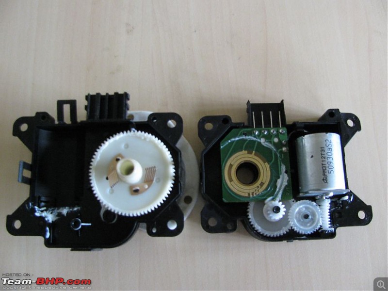

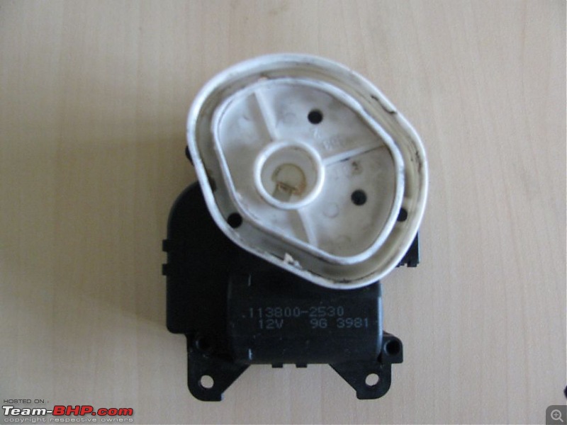

PICS - swift-vxi blower controller
Hi Guys,
My swift vxi was giving strange sound from left side of my dash board.
It was irritating and used to get head ache after driving for 15 minutes.
( i am also not getting indication lights around my odometer for petrol, oil, etc, etc... Also my central locking and A/c stopped working)
Maruti Authorised dealer said my cars ( to be specific RNS motors. Bangalore,yeshwanthpur) Electronic board is faulty and it costs more than Rs.15000. i was worried
Later I went to local workshop, the guy stated removing blower from below the dash board - he didn't find anything that makes sound other than some Rodent Poo.
Good news is he told me the electronic board is fine - if it is faulty car doesn't start. i was relieved.
Next he went further and disconnected the controller of the blower ( fan) which is used for AC also. now he asked me to start the car. There was NO sound at all.
so that sound problem is solved - blower Controller is the culprit (costs around 2500 for new).
Now i have to check my central locking , AC and indication lights around odometer
Another guy entered the garage who is a electrician, he removed the front right door plastic area and started checking the wiring and said the central locking device is faulty and he don't have a new device to replace - he also advised to get it replaced from maruti dealers.
And about the indication lights he said it would be some wiring issue under dash board and he needs one whole day for removing whole dash board.
AC should be checked at some other place.
I have added some pictures of my cars faulty device. Please share your opinions.
Thanks
Alex
alexrabbi is offline

Re: PICS - swift-vxi blower controller
Originally Posted by alexrabbi View Post
It was irritating and used to get head ache after driving for 15 minutes. ( i am also not getting indication lights around my odometer for petrol, oil, etc, etc... Also my central locking and A/c stopped working)
Alex
was this noise like a mini mixie running?If yes,it must be that the gear of the small motor inside the unit was not engaging ; the part looks in good shape to me even the white grease is intact Does your speedo work when you drive the car? Was the dash opened earlier?When did you note that the lights were not coming on? As regards the indicator lights on your dash not being available ; first check the main wiring coupler to the speedo console ; also please check if all fuses are intact.
vigsom is offline
Hi Vigsom,
Yes it used to sound like mini mixie.
Speedo works when i drive the car
Dash board was never opened.
even before the sound started
Also all the fuses are intact
