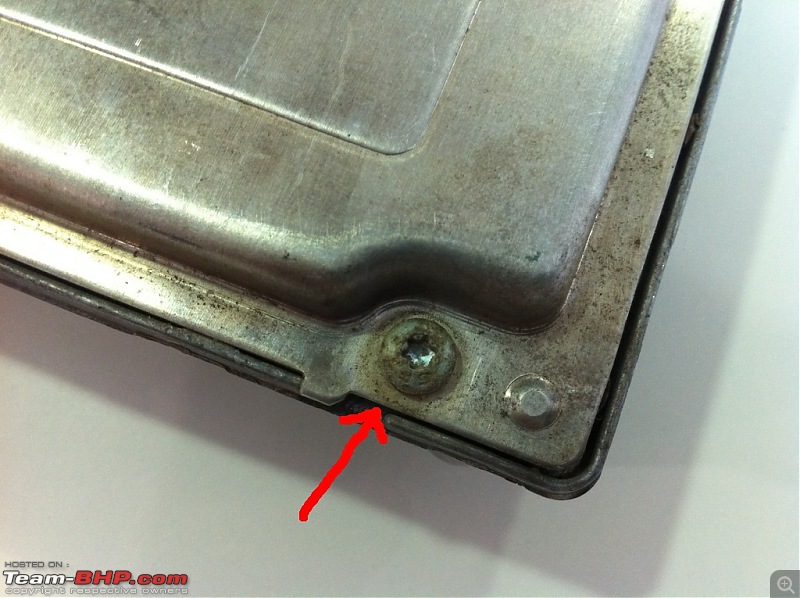

First look showed me telltale signs of water seepage and damage to the electronics was imminent:
Notice the corrosion on the bottom screws and cover plate, compared to the screws on the midsection and rest of the plate. The dotted line is up to where the texture/colour of the metal was different due to water damage.

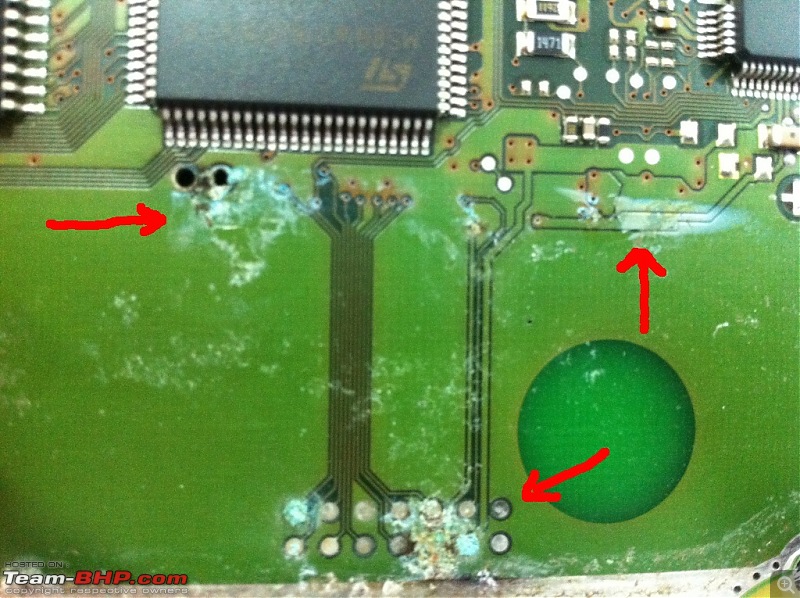

Once inside, this is what greeted me. You can clearly see the extent of corrosion - (the type that we see on batteries), but it is limited to the bottom part of the device (see dotted line)
I did also inspect the engine bay compartment where this is installed - it has a good drainage system and also the device itself rests about 2 inches above the bottom of the compartment, so I'm unsure how this kind of damage has occurred.
A closer view of the corrosion:
also affected some resistors+capacitors
and also an IC
anyways, Looking at it at this point of time, I'm like totally lost hope of any repair and ready to cough up the 90k for the new part, but a small engineer part of me still insisted that I should take a last chance and give it another shot.
Since the corrosive reside is a good electrical conductor, I figured it could probably be causing shorting between the IC and other parts hence causing wrong voltages to flow and generate the errors.
So I convince them (with my puppy face! lol) to let me clean up the part and see if it works, if it doesn't I'm ready to replace it anyways.
By now they have grown tired and empathetic of my situation, so they agree, but will not take any responsibility for further failures
I say OKEY DOKIE, just check if the car starts.
So that's what I eventually did - picked up some medical alcohol and a toothbrush, gave it a good cleaning, packed it up and had the technician connect it. One crank and the baby started purring like a little kitten!
They kept the car running for couple of hours to check if temp would cause any malfunction, it didn't. they cleared the existing errors and ran a diagnostic - results came out peachy!
I paid the towing charges, got into the car, drove home and shes running fine... since the last 24 hours at least!!
All in all ESTIMATED cost: 96,199/-
Actual cost: 3800/- for towing and diagnostics ++ some loose change for the alcohol and toothbrush!
but actual value is the experience gained!
