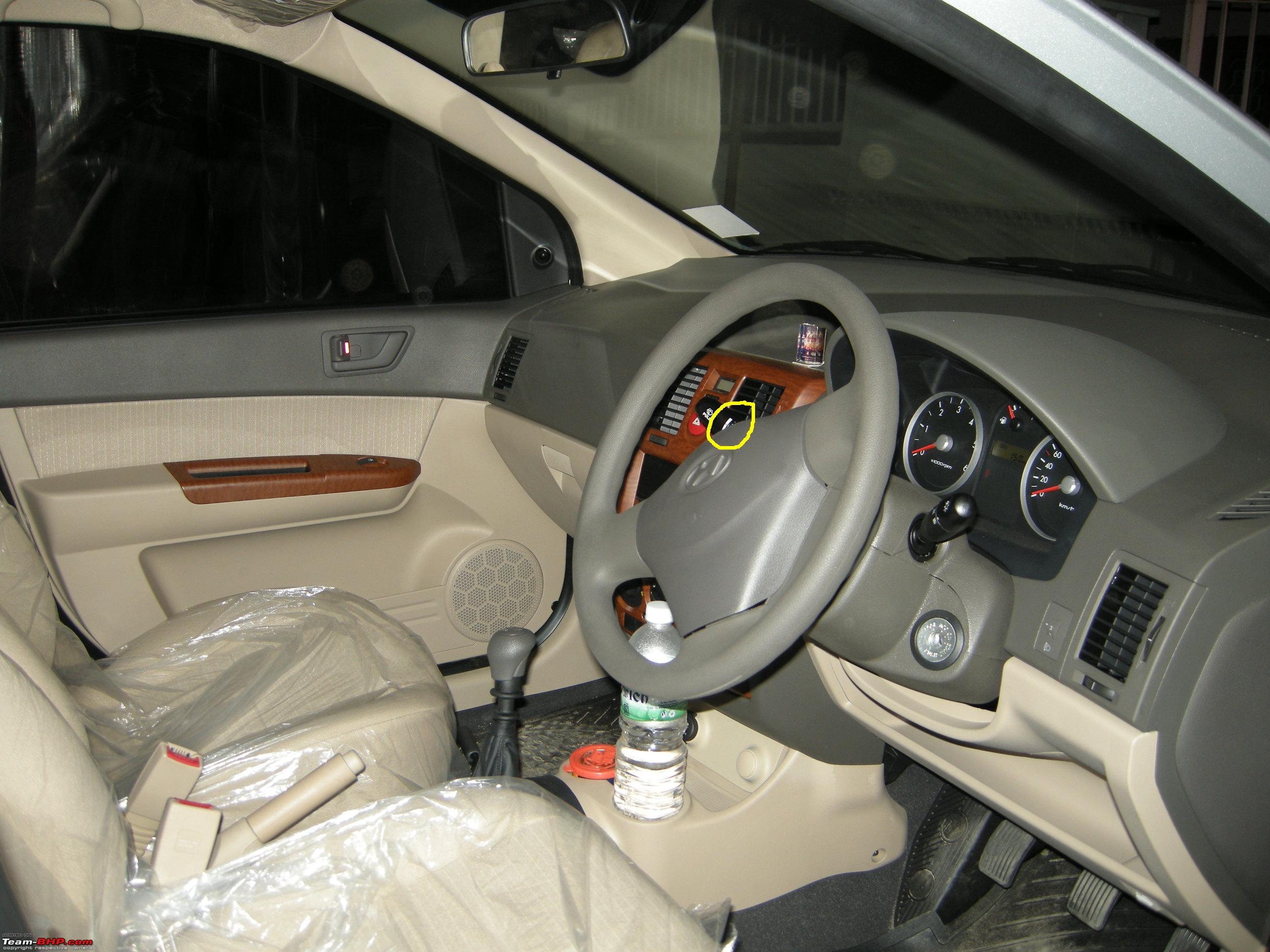

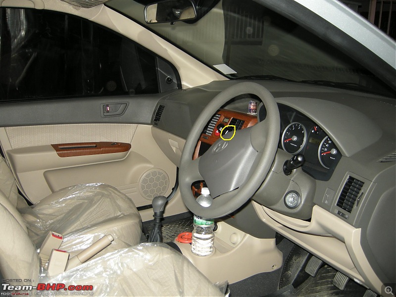

Hyundai Getz Prime (Petrol) has this feature with 4 adjustable intermittent speeds:

Hyundai Getz has this feature with 4 adjustable intermittent speeds:
Yup, those white bands are the different settings!
