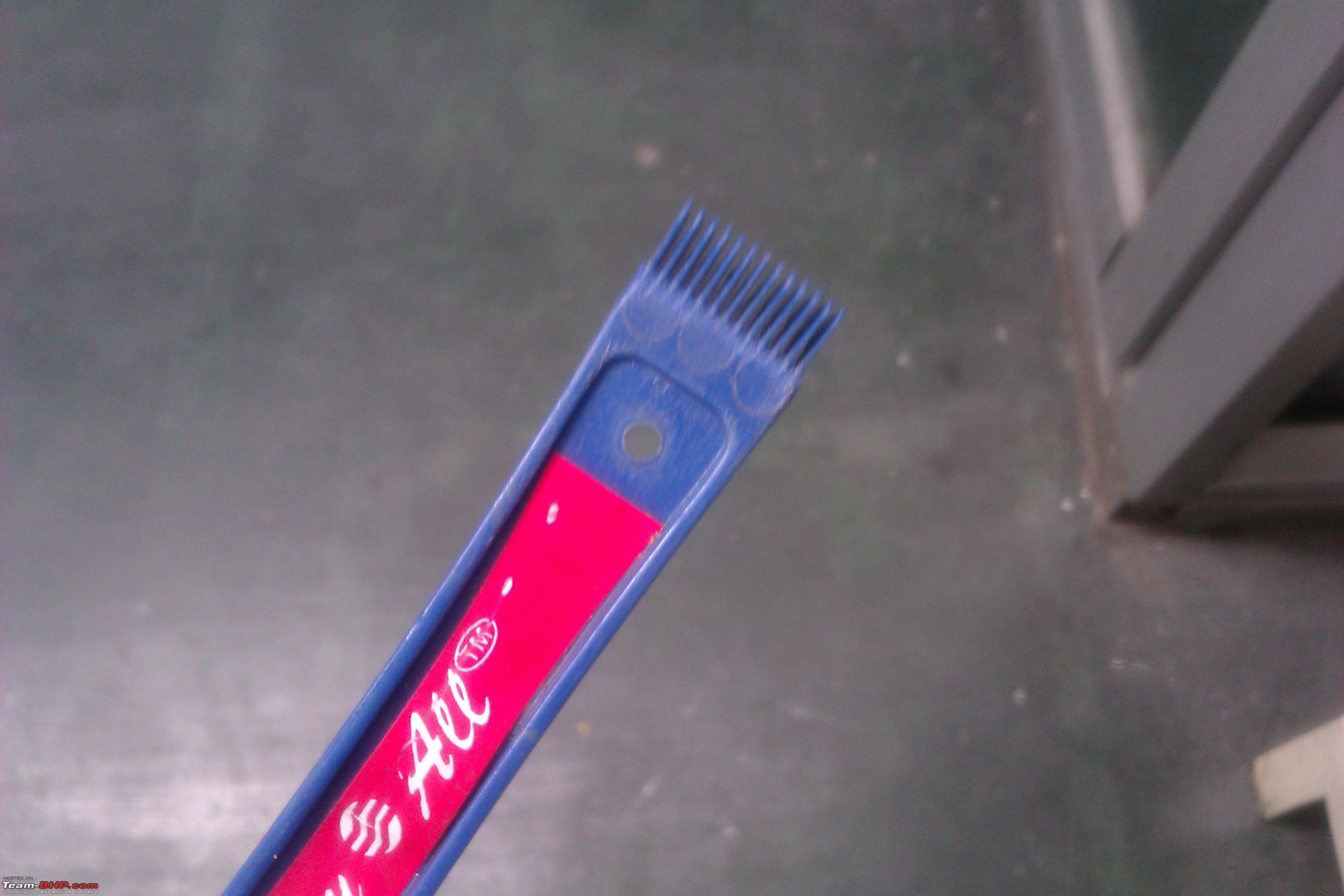

Use this for straightening the fins.
But i've never heard of a case where bent fins were the culprit for overheating.

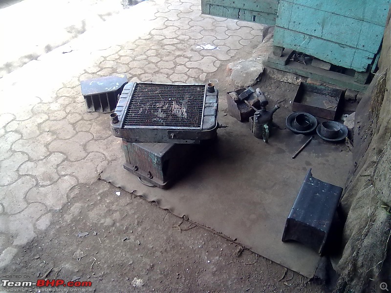

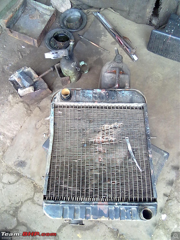

After my earlier post, I visited the RADIATOR SPECIALIST today & he just couldn't stop laughing on the COMB idea. No offense to anyone but these were his EXACT words "SAHHIB AGAR YEH SAB ITNA ASAAN HOTA TOU MAIN DUKAAN HI BAND KER DETA" (Sir if it was so easy, I would have shut the shop).
I took some photos of the work he was doing on some spot damage on a radiator. He was shy to get himself clicked & I didn't offend him.
He used a simple nose plier & screw driver, but like an artisan to fix the spot. I could not stay long to see him finish the job.
His advise is to use kitchen tongs (the ones used to flip chapatis) & straighten each fin, one by one. Patience is virtue.
His ENTIRE shop (Under those wraps are HUGE radiators of ship generators)
His "Patient" on operation table
A close UP (If you look closely on tools, you can see nose plier, this is what he was majorly using to fix the spot.
