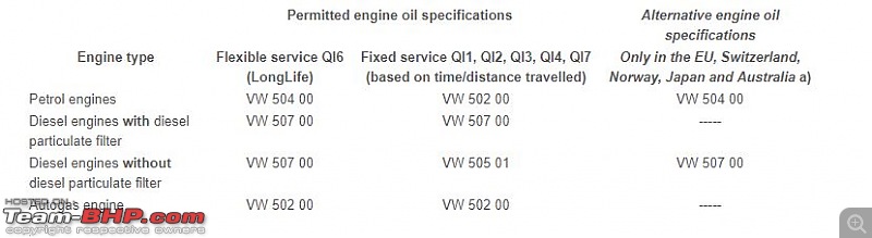

My knowledge of VW engines is limited however I’ll try to help the best I can.
My research tells me that VW in India sold 5th generation Polo (Type 6R/6C/61) with a 1.6L turbocharged straight-4 16-valve diesel engine that developed 66 kW (90 PS) and 77 kW (105 PS) in two different states of tune.
VW 505.00 is actually an old diesel spec., the current spec is 505.01. However, since some of the VW diesel cars at that time sold in India were without DPF (I assume owing to poor quality diesel fuel/high sulfur content), I assume VW is using an older spec just like many other global manufacturers operating in India.
Please note that using a VW 505.00 oil in an engine that calls for VW 505.01 specification is not recommended. I'm sure there are lubricant manufacturers/marketers operating in India that have a suitable engine oil that meets 505.01 (e.g., Liqui Moly). Liqui Moly markets TOP TEC 4200 5W-30 oil in European markets that meets both the 505.00 and 505.01 specifications. You will have to confirm its availability in India.
Please also confirm if a particular viscosity of the engine oil is also recommended in the manual such as 0W/5W-30 etc. (very common for a number of VW engines) if not then Shell Helix Ultra 5W-40 should be okay as long as it meets the OEM's recommended specs. Please also consult your SA at the local VW dealership.
I cannot emphasize enough that you must exercise extreme caution with small displacement European diesel engines as these are very high compression ratio/close tolerance diesel motors that operate at relatively elevated temperatures and are very temperamental.
I’m enclosing a couple of charts that will also help (source: vwpolo.net and oilspecifications.org).
Skoda / VW Group Engine Oils-vw-oils.jpg
Skoda / VW Group Engine Oils-vw-oils-1.jpg

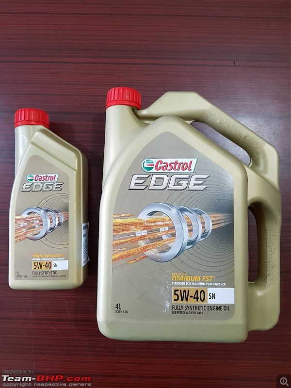

I last used 100% synthetic Castrol Edge Titanium 5W40 5L Engine Oil complying with VW 502 00 / 505 00 and API SN grade, for servicing my 2012 1.8TSI MT Skoda Superb. The MRP was 3446+1047 = 4493/- but I got the oil at net 3000/- bucks with vat bill. 4.6L is to be used in the oil change (with filter replacement) and the rest was kept as spare for top-up.
Skoda / VW Group Engine Oils-1524213428728.jpg

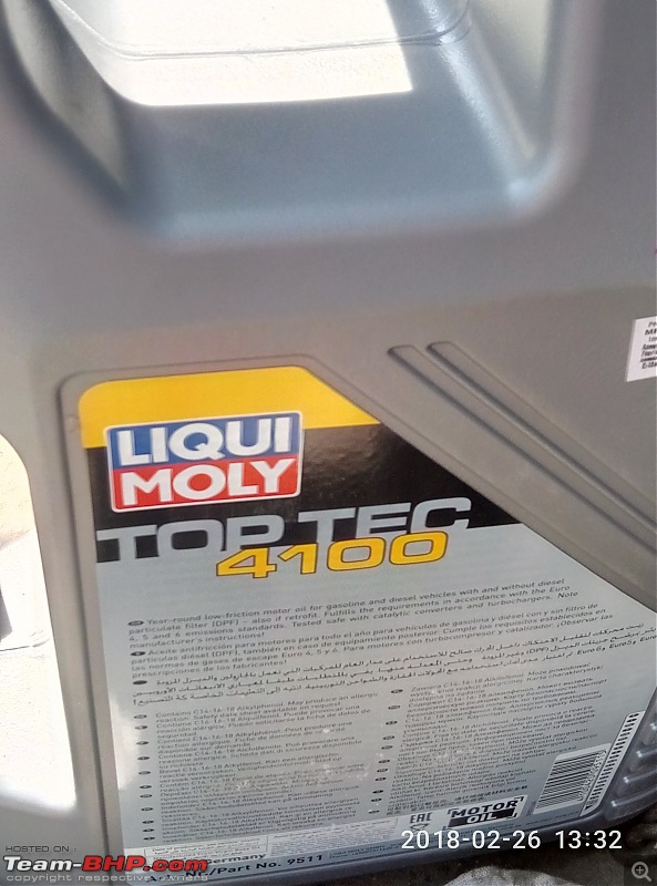

Got the rapid services, outside of the Skoda Service, since they were pressing for the ill famous software update.
Used Liqui Moly Top Tec 4100 synthetic oil conforming to VW 505.01 standard.
Its been about 2000 kms since the service was done. What is surprising is that the car has become softer sounding, smooth in pick up and somewhat silent while driving.

Spoke to some technical person in Castrol (company) he said the nearest product to VW505.01 is Castrol Edge which is fully synthetic 5w40 available in open market. He did not admit that Edge is the same one supplied to VW but he kept using the word 'Near/nearest'.
Let me add here, the Castrol Edge though being 5w40 mentions 'MEETS OR EXCEEDS INDUSTRY STANDARDS:VW 502 00/ 505 00' and does not mention VW 505 01 sadly.
And by this understanding if I go for Castrol Edge 5w40 overlooking the 'VW 505 01' spec, I can also think about other brands as well. Right?
Hence I am still confused. Should I go ahead with any 5w40 or should I just go to the authorised dealer for the sake of 'VW 505.01' oil that only they have.

Passat service done at Sureshbhai (98204895080) near link road, Borivali west.
Engine oil used: Liqui Moly 5w40 TopTec 4100 (fully synthetic)
Ordered from: sparesncare.com (online website Gurgaon, Ph 8368071335)
Price: Rs.4000 for a 5 ltr can
2017 service detail: 3372489 MAG.PRO OE5 (Castrol Magnatec professional), VW part number OL3372489, Liters 4.3, Total amount (with tax) Rs.4041.98

Hi All,
Any leads on getting the Liqui Moly or other 505 01 compliant engine oil for Skoda in Bangalore (brick & mortar) is highly appreciated. I would like to skip the online options for the moment.
Apparently its not a common commodity in the market.
thanks.
Have you tried the JC Road market? What I heard last from a friend is Liqui Moly is easily available everywhere. If that doesn't help you can contact the below.
Ansysco Anand LLP
Mobile: +91 8091090261
Email: ansysco@anandgroupindia.com
They are the importer for the same. Above details were taken from the label stuck on the 5L can which I bought from Amazon.
If you cannot source Liqui Moly I would suggest you to go with Motul X-Clean. Brilliant oil. NVH levels dropped almost 90% compared to OEM Castrol.
