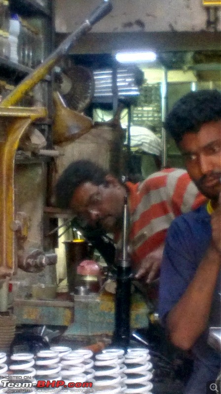

My seven year old Figo's shocks had lost all its juice (leaked out over the period of 7 yrs), the service advisor at Ford recommended replacing the Front Shocks and Rear Dampers (during regular service). The total estimate was going up to rupees 15 thousand (it was over the phone so didn't request a printed quote). Before going for new set of shocks I wanted to check how could it be restored/repaired/refilled. The hunt begin and I came across many amateur mechanics who would drill a hole to drain the fluid and then seal it back after refilling and blah blah. Finally I found a mechanic who had sound knowledge and equipment to do the job (his primary business is assembling aftermarket shocks for bikes). Considering the Figo is only used by my wife for office commute which was not more than 6 KMS/Day. I decided to take chance at getting the dampers refilled. Total damages 3k and three hours. Please forgive me for low res mobile pictures. This is how it was done:
Jacked-up--Shocks Removed-- Disassembled (using hydraulics)-- Refilled Fluid-- Seals replaced-- Reassembled (using hydraulics)-- Refitted.
Though the car feels as good as new, I would not recommend this kind of fixes and best to get such old parts replaced. But Kudos to the mechanic and quality of his work.
+1 Sir.
Best is to get the new set for the sake of piece of mind and better performance. Did you change the boots during this job? I mean the rubber parts in the assembly?
Hope the shock absorbers survive and give more you serviceable life.
How were the dampers disassembled and reassembled? Was it done with a lathe? Please don't be defensive about your decision, it is an experiment and we are eager to see the results. Please keep posting your experiences.
My personal experience is that if nothing is broken inside except the seals, a change of the fluid and new seals does the trick. You lose a bit of travel, but it is no big deal. But if an internal component is broken, then it is best to discard the unit as spares are not available and the repair doesn't hold.
EDIT: Just noticed that front dampers are gas charged. Did the mechanic manage to pressurise the shock absorbers? If yes, how?
