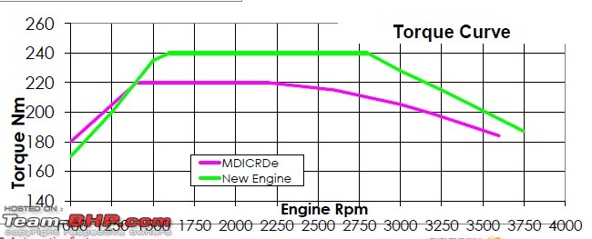

Attaching below the Torque curve for the Quanto engine (source: the pdf shared earlier on TBHP).
Would be interesting to compare it with the torque curves of other engines. If someone can post them over here, it would be really helpful.
Attachment 989600
Thanks Autoindian for this curve, this perfectly compares how much improvement that engine has made. But disappointing that percentage wise, it is very small (9%). For such improvements why do so much modifications ? and the peak torque is coming later than MDICRDE engine. And important point - the torque point is moved later than before. It is not coming earlier. I have penned down my version of thoughts below.
