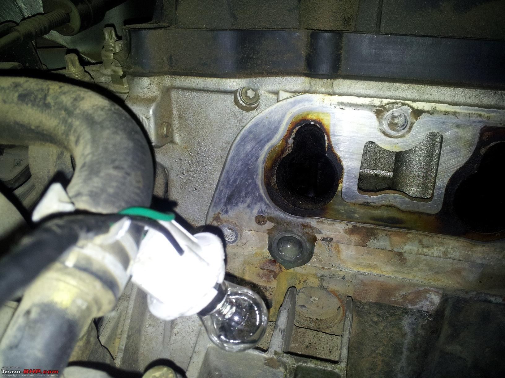

hey All, update on the problem. Sejal motors fixed the problem about a week ago. I had to leave the car at the garage over the weekend because he could not source the right sized dummy cap and the car without the intake manifold was lying paralyzed in his garage. Posting some pics taken during the repair.
The dummy cap that caused it all
2004 Ikon Flair with corroded dummy cap and drained coolant-20121005_155951.jpg
Dummy cap's location, look at the area circled in yellow
2004 Ikon Flair with corroded dummy cap and drained coolant-20121005_160322.jpg
Complete shot of the engine without the intake. Please ignore all the dust
2004 Ikon Flair with corroded dummy cap and drained coolant-20121005_160345.jpg
This pic shows the new cap in place with araldite around it. Fixed for good.
2004 Ikon Flair with corroded dummy cap and drained coolant-20121008_182731.jpg
The car is working fine. Overall satisfied with the workmanship. However on a side note, Suresh from Sejal motors told me that he sourced the part from Ford and had to pay for the labor as well since they wouldn't give spares. But one of this main mechanic had happened to tell me separately that they got it made at a lathe machine . Anyways he probably overcharged a bit but I am not complaining since the garage is 1 min from my house and saved me all the hassles of towing etc.
