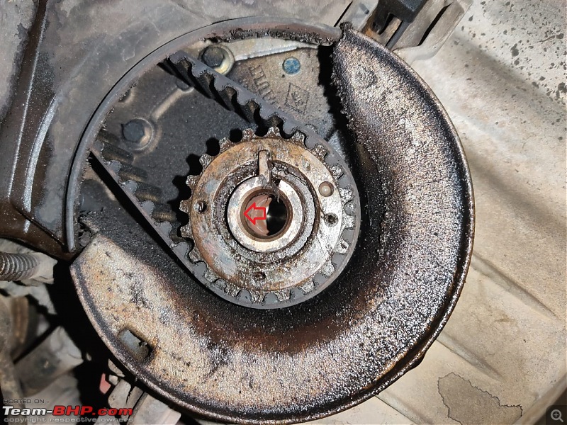

To me, a major cause of concern is the excessive play in the timing pulley...
Renault Duster 110 : THUD sound & vibration on engine startup-e3cdaac7da804884813426d37514ded1.jpeg
Can they, Renault explain that? How come they are not talking about that? Why only the belt slip theory.
Also, lower block which houses the oil seal doesn’t have any coolant gallery. If the coolant in the cylinder block would go high on temp to buldge the oil seal, the seal would have melted accompanied by the high temp warning.
They should show bulge/heat damage on oil seal to prove their theory after they explain the play in the pulley.

As far as i know, toothed belts don't slip unless the teeth have worn out or tensioner is broken or weak. So, i seriously doubt the belt slipping due to oil.
As Tgo has mentioned, it seems that the widened notch in the shaft has changed the timing.

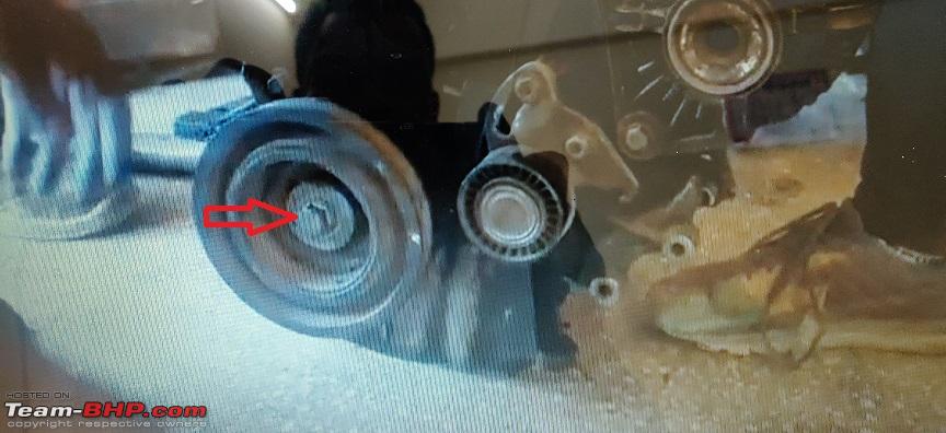

I have another doubt, in the photos I see that the timing pulley is not secured by any kind of nut. I googled and found videos where the timing pulley is secured using a nut and timing belt of my car was changed at 60-64k kms. I seriously doubt if the person who changed the timing forgot to put the nut back and left it open resulting in the the cam shaft's notch to widen. If anybody knows if the timing pulley will be secured by any nut or left open please comment.
Image 1 : From my car ( red arrow to mention where nut should have been put), other images are from google.
