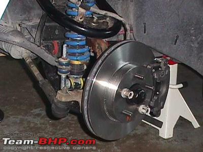

Hey Guys,
Here's a thought i have been having for some time now - we've all been hearing about the mini SUV segment, now i know that there are quite a few car platforms out there which are being used as the base platform for a Mini SUV (or) a future Mini SUV.
what if, we can choose to convert our Hatchbacks (HB) into Mini SUV's overnight! so we might not have the look of a originally designed Mini SUV, but at least enjoy the added benefits, like not getting the base of the car scrapped on every mountain of a speed breaker the Municipality puts on our Roads!
I am no mechanic or car guru - but i think this is what you need to do it, apart from the money, time and guts to make the change:
1. Higher Suspension - we need to increase the height of the suspension, raise the ground clearance of the HB from the usual 160-180mm to around 200-210mm at the minimum. This will mean a couple of things
(a) you need tires which are bigger i.e. move from the usual 13-14 inch rims to maybe 15-17 inch, depending on the size of the place the tire sits and of course wider tires. In some cases there might be the need to cut a bit of the metal/plastic around the tire space to accommodate the larger wheel and tire, but that can be done aesthetically as well. Cut-Shape-Dent and Paint.
(b) raising the height of the suspension - you would need to use a spring with more coils, and/or a larger diameter of coil and tubing. I am told that on most coil and leaf-spring-equipped suspensions, ride firmness will remain close to stock on lifts up to four inches. From there on up, ride becomes increasingly firm.But the caveat is that along with this increase in height come performance tradeoffs. A tall spring will cause the vehicle to feel unstable during cornering. This instability is because the more distance a spring compresses or extends, the more the vehicle "rolls" around on its suspension. also weight transfer can overload a tire's grip, which ultimately hurts traction and handling added to uneven wear and tear of the rubber. But/however i have read somewhere that if you use an adequately wide tires, then this issue can be negated to a large extent.
2.Modifying/dropping the swing-arm to accommodate the increase in height
3.Adding a bull bar up front for the butch look
4.adding roof rails on the car for the oh-so-SUV look
5.Add a step in, just so it looks cool
6. lastly, plastic cladding/mould around the car, like a wraparound bumper which the fiat adventure had, to finish off the look.
I understand that there might be some folks who will come out and say that this will compromise the ride and handling of the car, i don't have any answer to that question, but I am hoping someone ingenious out there who can come up with an intelligent solution to solve that problem.
in case this takes off, before you know it - the OEM's will step in and start offering this as an option. but if we can do this on our own, we have a really inexpensive option of converting our old HB's into Mini SUV's and give it a new look and lease of life for some time to come
This is just a thought which has been playing on my mind when i heard/read that some of the car companies are using their sedan/HB platforms to foray into the Mini SUV segment; with the Mini SUV's being priced at a might higher level than their sibling Sedan/HB's.
Cheers,
Aries

This is not to personally hurt your intentions. Appreciate your effort in asking out for help.
But seriously?!! Raising the suspension, adding bull bars will make a mini-SUV?. If ride height is the problem, look for a car with a good ground clearance and if required choose firmer suspension setup to ensure the vehicle doesnt scrape under load (Improved dynamics is an added advantage!)
For a moment i felt sorry for seeing such a topic in TBHP. If ever this gets completed, i doubt if it will ever find a place apart from perhaps "Wierd and Wacky mods" thread.
Again sorry for being rude, but this is exactly how i felt. Mods delete this post if it is offensive,
These platforms are also strengthened for the additional load & stress. You wouldn't really be able to do that in the after-market.
What that'll mean is you lose the dynamics & handling benefits of hatchbacks.
With a suspension lift, ride quality is out the window too.
At the end of the day, how much ground clearance do you really need? Most B segment hatchbacks have sufficient clearance to handle 99% of Indian roads.
Remember, tacking obstacles is about technique too. On a recent trip to Pawna, I took the C (all of 140 mm of ground clearance) over terrible roads without scraping once! This was with me, Rehaan, Samurai, Mpower & Vid6639 onboard. You'd have to see the roads to believe it. Of course, it required a lot of patience and really slow speeds; a Duster or Safari would have flown through these stretches and there's no denying their rough road advantage.

Wishes apart, but wont raising the suspension to the limits need a change of tie rods, steering linkages, transmission etc?
Nice idea, but let me put down some of the thoughts that came to my mind when I read this. I seem to be having a negative bias to this for some reason. Apologies in advance if it seems offensive.
With all these changes you mentioned, you are most likely going to end up paying more than what a mini-SUV costs. This is definitely not an inexpensive option. If you want to try it out yourself to get the experience and has enough budget to get through to the finish line, its probably worth trying.
Since you have to modify the body panels to accomodate bigger tyres, these have to be custom made. This would translate to costlier spares in case of replacement as you would need to fabricate them in case of any damages to existing ones - something you can expect if you plan to drive this on Indian roads considering the road manners of the general public. When it is a one-off car, chances are more since even some of the otherwise responsible drivers tend to try capturing a pic on the mobile and would be driving with diverted attention.
If you plan on doing any offroading, modified suspension components could give you problems much sooner than you think, as we cannot do the stress testing that manufacturers normally do with any configuration. If not, the increased ground clearance is not going to be of much value anyway.
With wider and totally different diameter tyres, steering might need to be recalibrated to address oversteer or understeer as the case may be.
Aerodynamics could also go for a toss leading to poor performance and FE, increased body roll and so on.
Personally, I'm not sure its worth the effort unless you want to do it as a DIY and learn from that experience. If that is the case, I think this would give you tremendous learning in designing and building a car which would be helpful for your next venture.
yes, but i think only if the height change is a little extreme, maybe for a 10-40 mm difference there might not be the need to change all of the existing mechanicals.

I would stay away from such wild thoughts, they do come (sometimes to me as well), but at the end of the day they do not make sense. Thinking financially, Driving dynamics, Maintenance, and overall headache when things go wrong when they are not supposed to.
GTO, had put it rather well.
If a car was not designed for the load, or higher GC, or bigger tyre, it will start pushing the ability of related parts to last longer. The after effects are these parts start giving up, when they should be going-on-and-on.

What that'll mean is you lose the dynamics & handling benefits of hatchbacks.With a suspension lift, ride quality is out the window too.
what if, this is a small lift, not like the ones they do in the US for their pick up trucks, just a couple of inches to acomodate the larger wheels.
16 - 17" wheels & tyres add a lot of weight, not something that a puny 1.2L / 1.3L engine likes to haul. So, not only do you lose your dynamics, even power goes for a toss!
i could be wrong here, but i was told that the 1.5 Ford Engine which does service on the fiesta is also being employed in the EcoSport, or the Renault engine which is also going strong in the Duster - maybe it has a different state of tune for higher torque, i think this could also be done if needed. even the 1.3 Fiat multijet pulls the Ertiga which is heavier than its siblings. Again, i am letting my imagination go out on a limb to think "why not", this stems from a strong hatered for city driving in Bangalore where the speed breakers are humongous and the potholes come out of no where on a clean road, especially tough to catch when i m doing 60-70 Kmph in the night. I swear and wish "what if" my HB could be 10-20 mm higher with thicker tires.
After-market bull bars actually cause more damage than good (to your own car and the person / vehicle it knocks into)
- this was just for the butch look, but i dont like them much either. The ones i see on the Indicas really put me off.

Its a good idea if you want a modify an old hatchback to use it in rough roads only. Wouldn't hurt sometimes to have creature comforts in addition to the high ground clearance.
Trying to use it like a regular mini SUV would not be good since the dynamics are disturbed.
