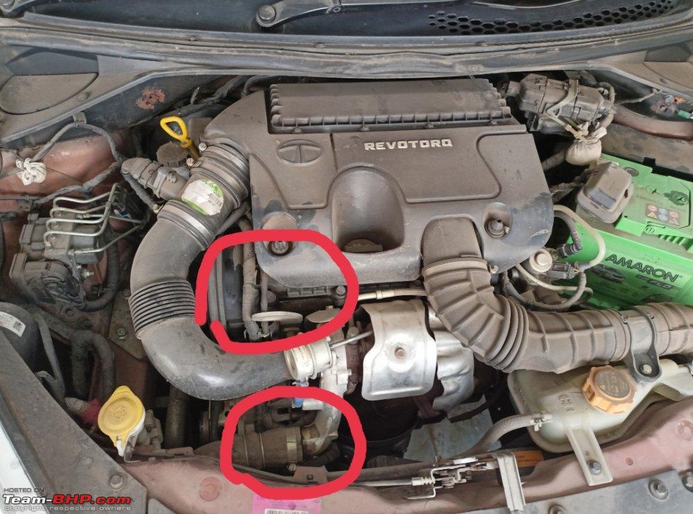

My tigor diesel has covered 69500+ kms today, while checking the engine bay saw some oil marks on the left side of engine head-block joint. Also there is soot deposit where the hose from intercooler meets the turbocharger, can this be signs of something bad? is this typical with ageing of diesel engines?
I am concerned about the soot near the turbocharger-intercooler hose joint, the last thing I want at this point is turbocharger gone bad.
I follow all thumb rules of idling the car. I will get my car inspected with the service center, but any insight from fellow members will be helpfull.
Attaching picture.
