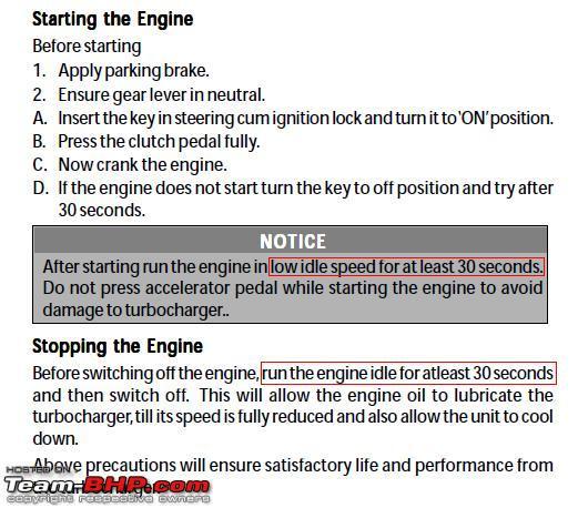

Maruti, Hyundai & Tata have 2/3rds of the passenger car market. Here’s what the big three have to say.
From the Dzire's owner manual:
