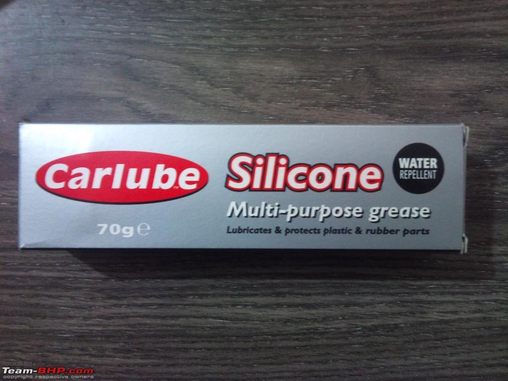

SS, the suspension bushes are not that expensive but i do not want to take any chances with critical suspension parts and hence the apprehension in using silicone lubes with petroleum content.
My quest for a silicone lubricant ended on ebay and i ordered something called carlube which is is supposedly pure silicone. Cost was abt. 800 bucks (a 70 gm tube) including shipping.
Interestingly, two or three days after i ordered the silicone lube, the suspension noise stopped by itself. Observed for a week now and the noise has really gone (for the noise vanishing by itself) and (for all the effort put in to find a good silicone lubricant )

Did it rain just before the noise stopped? If it did then this stoppage on noise is temporary. Again speaking from personal experience.
