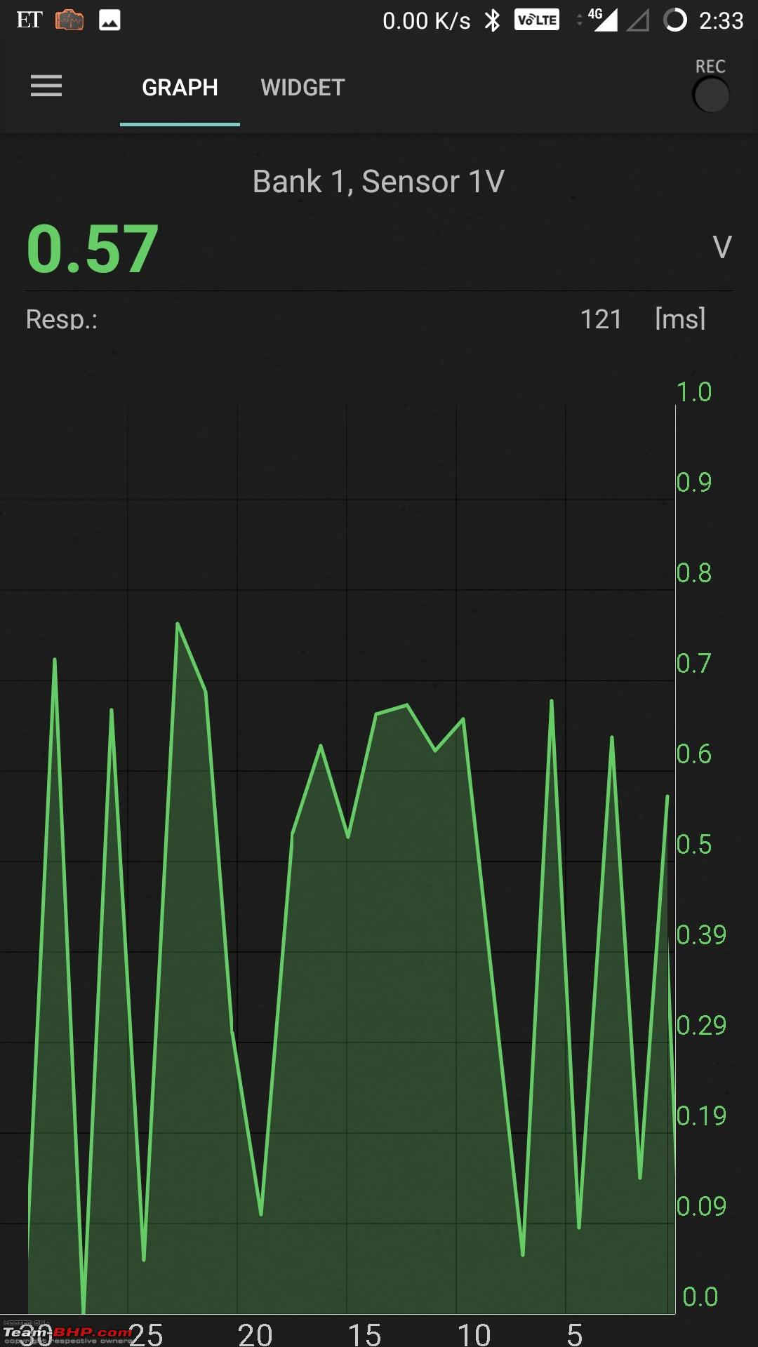

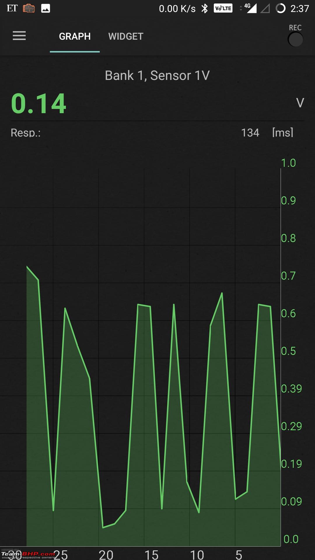

Knocking on a old thread for some advice! Hope y'all still there xD'
I was looking at my o2 sensor readings and noticed that the values doesn't go as far above the mid-point as it goes below. I have tried taking readings at idle, 1500 and 2500 RPM and the results are fairly similar.
Coincidentally, I am facing low fuel efficiency issues as well. Am I looking at a faulty sensor?
I have added screenshots! Any inputs will be much appreciated
Does downstream O2 sensor affect fueling and FE in Petrol Engines?-screenshot_20180709143317.jpg
Does downstream O2 sensor affect fueling and FE in Petrol Engines?-screenshot_20180709143328.jpg
Does downstream O2 sensor affect fueling and FE in Petrol Engines?-screenshot_20180709143440.jpg
Does downstream O2 sensor affect fueling and FE in Petrol Engines?-screenshot_20180709143700.jpg
Does downstream O2 sensor affect fueling and FE in Petrol Engines?-screenshot_20180709143824.jpg
kifilshah is offline

Which app is this? I suggest you take the readings again with the display in the dial mode instead of graph mode. Somehow I think that readings in the graph mode of display are too lower than actual.
In my case, the graph displayed coolant temperature at in between 77 and 80 degrees while at the same time dial displayed it at 91 degrees.
So, before proceeding for any further investigation, please try this!
