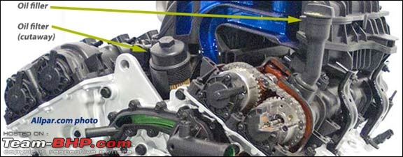

The vehicle in question in a Jeep Grand Cherokee 2014 in Qatar. I noticed small oil drops in my parking area for a couple of days. First I had brushed it aside, thinking someone else would have used my parking slot during the day, and hence the oil droplets.
After a few days, the patch on the ground grew in diameter, that is when alarm bells went off and I got down on my knees to take a better look at the underbelly of the Jeep, found it soaked with oil. With a racing heart I open the hood, pull out the dipstick to check the oil level. It was not bad; it had come down from the MAX marking, but still above MIN.
So I head to the dealer, early morning Saturday. Hoping that I could get a technician to take a quick look and conclude something small like the oil filter was not tight enough, hence the leak, we shall replace the o-ring and top up for free as it is just 2000 kms since the last service, where we had replaced the whole set….
However, nope, none of that happened. The service advisor says the earliest he can assign the vehicle to a tech is late evening on SAT or early morning SUN. I did not want to risk driving without knowing the actual location of the leak, even transmission oil was changed during the last service, so I had that too on the suspect list.
Now I got a call from the Service advisor who claimed that the oil filter adapter was the culprit and the leak is from that unit. The vehicle is still under warranty so that will get fixed without a cost, I might have to pay for the oil top up.
I tried conveying a point that, the vehicle has run only 2K kms since last service, so maybe the tech who worked on it last time had damaged the adapter, either tightening the oil filter a little too much or did not put the o-ring in place. But the Service advisor got all aggressive and said NO, these thing happen once in a while, you cannot blame service. He is a new chap, who I had not seen at the dealership earlier. Maybe he is under probation hence a little touchy about an unhappy customer suggesting the root cause.
I would be heading over to the service center in the evening to collect my ride. Before that, I just wanted to get an idea, what causes an oil filter adapter leak? I am also doing some reading online to get an idea.
The oil filter is located on the top, under the engine cover.

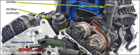

The oil filter adapter housing.
Oil Filter: What matters and what doesn't-adapter-housing.jpg
Sorry about the rant, the call got me all upset. I tend to my jeep a lot, so a leak, if it is from shoddy work or a faulty part got me a little worked up. I feel a little better after typing this out.

I tried conveying a point that, the vehicle has run only 2K kms since last service, so maybe the tech who worked on it last time had damaged the adapter, either tightening the oil filter a little too much or did not put the o-ring in place. But the Service advisor got all aggressive and said NO, these thing happen once in a while, you cannot blame service. He is a new chap, who I had not seen at the dealership earlier. Maybe he is under probation hence a little touchy about an unhappy customer suggesting the root...
It is very easy to screw up a filter replacement, by either under or over tightening. Wrongly set O ring can cause a leak too. Please let the higher ups know what had happened, so the technician who did the job gets a feedback. Please keep in mind that the objective is to prevent a repeat in the future, rather than having his head on a platter.
