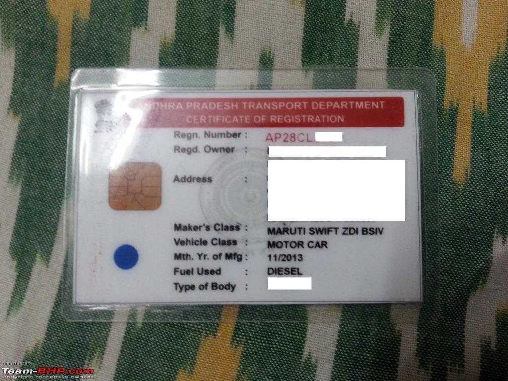

How do I find out if my vehicle is a Bharat Stage IV. I have a 2014 Toyota Fortuner. Is it mentioned in the booklet (need to check still). I checked on the RC and on the car body, I could not find it?
The RC book does mention it.
This is the RC for my Swift ZDi. It does say it is BS IV.
Anurag.

My car is registered in UP and it does not mention it anywhere :(
Some states may mention it in the Registration Certificate/Card, some may not. But there must be mention in the car owner's manual, or somewhere else in the ownership documents. The manufacturers are supposed to submit a certificate to that effect to the registering authorities, and if that process was done by the dealer, you may not have seen it. Some cars, when new, used to carry a sticker saying "BSIV", but that may have been prevalent when changing over from BSIII, and discontinued now.
