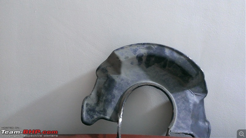

Here is what the shield looks like (after he twisted and yanked it out from behind the wheel hub):
Not buying his bull-cr@p, I have a few questions:
  1. I'm sure that Disc Brake Dust Shields (also called Splash Guards) are there for a purpose. Probably, as the name suggests, it prevents water from splashing into the disc brake/rotor and perhaps also prevent road grit from hitting the moving rotor which probably might be dangerous thing if it happens. Otherwise why would a manufacture put the shield in the first place? Or is it to comply with some CMVR rule? On searching the net, I found conflicting/incongruous articles, with some experts saying that its OK to let go of the shield, while many others also indicating that it is necessary part for wheel's long term health and safety.
    What do the experts here suggest?
  2. Has anyone gotten this shield replaced, say, due to it rusting out etc. That would at least give me some comfort that there is infact an OEM/MGP spare for it, and then I can go to the nearest MASS and get it replaced.
    Or is there any truth to the mechanics assertion that the shield only comes factory fitted and once removed there is no way or means to put a spare one back? Personally, I find it a bit hard to believe.
    How worried should I be due to shield not being present on one of the front wheels? I hope it doesn't compromise the safety of the brakes.
I'd appreciate if an expert BHPian experienced in this could chime in. Otherwise I was thinking of going to MASS to inquire myself.

Dont be too tensed about driving around without the shield. When its a fact that it helps prevent wedging in pad/discs and somewhat protects from splashes and dust, there is no immediate harm in driving without them.
However, please get it replaced from MASS. I'm sure you will get the part, unlike what the mechanic told.

Dont worry too much, this shield stops stone hits from damaging your disc. At the next service ask the MASS to replace it. I am sure this would not be in their items of inventory, so it would be a good idea to ask them to order it a few day before you land up for service.

You can buy it as a spare part from Maruti dealer. Part no. is 55321M62J00 ( cover brake disk dust ) Price should be approx. Rs. 60.00. Any good service station can replace this. But
You will have to remove hub again. I suggest replace wheel bearing also.

this for swift. Its car specific. Not common for all cars.

I furiously called up the Gem Motors SA, and informed him about the general availability of dust shield and the MGP Part Number mentioned earlier by abhijitl.
He was left red faced and out of words. Sorry saaar, I'll source the part for you in 3 days. Gawd Promise - came the reply . Hope to get the shield back in place.
I'm surprised that the even the so called authorized service center personnel go to a great extent to shirk their responsibility although they charge for hours of work. The service center themselves acknowledged it as a fact that they don't replace this part once taken out as they don't consider it important enough to put a spare back. I think that's clearly a case of gross self diagnosis and intentional negligence, which might put customer's life and vehicle's long term health at risk (however little that might be). Here, I followed up, thanks for the suggestions from fellow BHPians, but I think I'm probably the first one to insist on it, and I'm sure there are several hundreds who don't even know that they are missing a part of their braking system, or may been have been short changed.
BTW, SA is saying that putting it back will cost me another 3-4 hours of labor, which should have cost me none had he fixed it earlier in the first place
