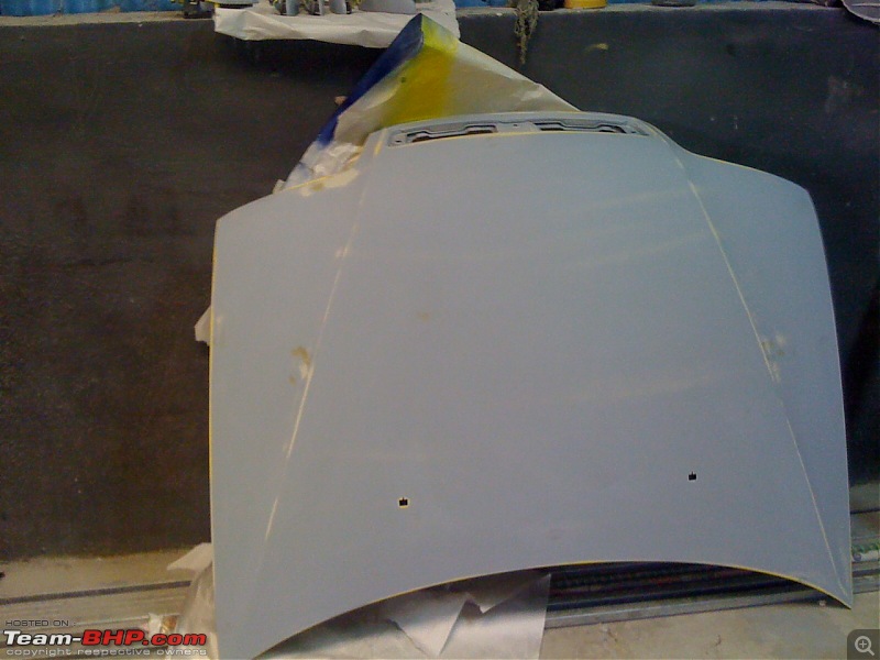

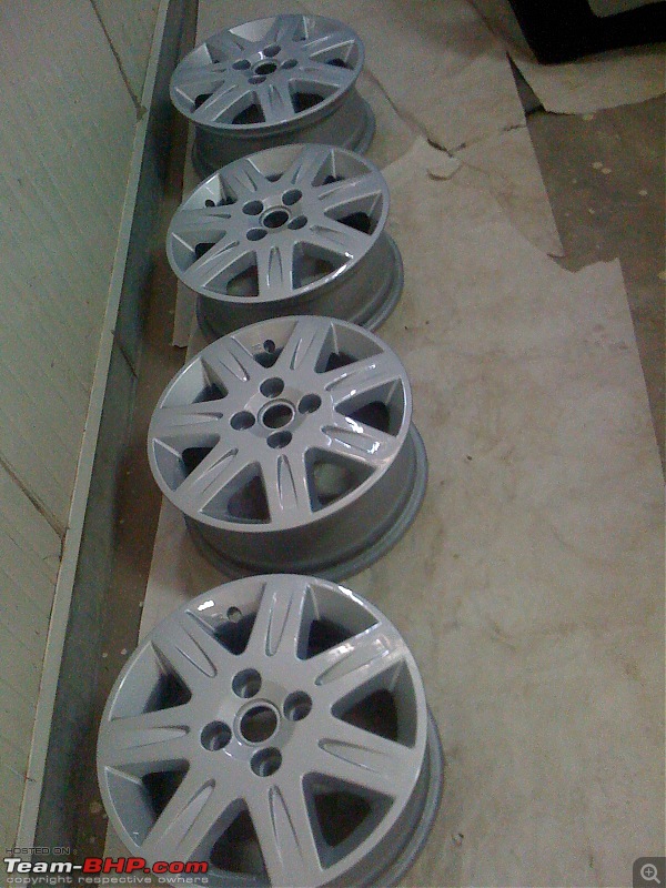

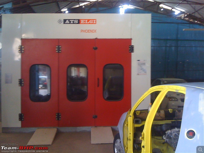

Some brief history on the car and details of the resto job
  1. New strip down painting(enclosed the pictures of the job)
  2. Paint used Siekkens 2k Advanced with Dupont Chroma clear. The car was baked and painted in the most advanced booth with airless drying technique for long lasting gloss and finish. Only Bondo fillers were used. The car was entirely build from scratch even though it was in good shape.
  3. Complete engine work has been done. Replaced pistons, fuel pump, exhaust valve, timing chain, custom radiator,clutch plate, pressure plate and release bearing.
  4. New Timing chain, Idler bearing and tensioner (fiat ricambi OE).
  5. New throttle body (magnetti marelli),
  6. New air intake hose,
  7. New headlamps .
  8. Fiat mulipla badges Uk import 100 16V, New S10 C pillar badges and stickers.
  9. Replaced all alternator parts with complete overhaul.
  10. New battery and side mirrors
  11. Speedex custom number plates
  12. Raj exhausts (mild with custom end can) not full headers
