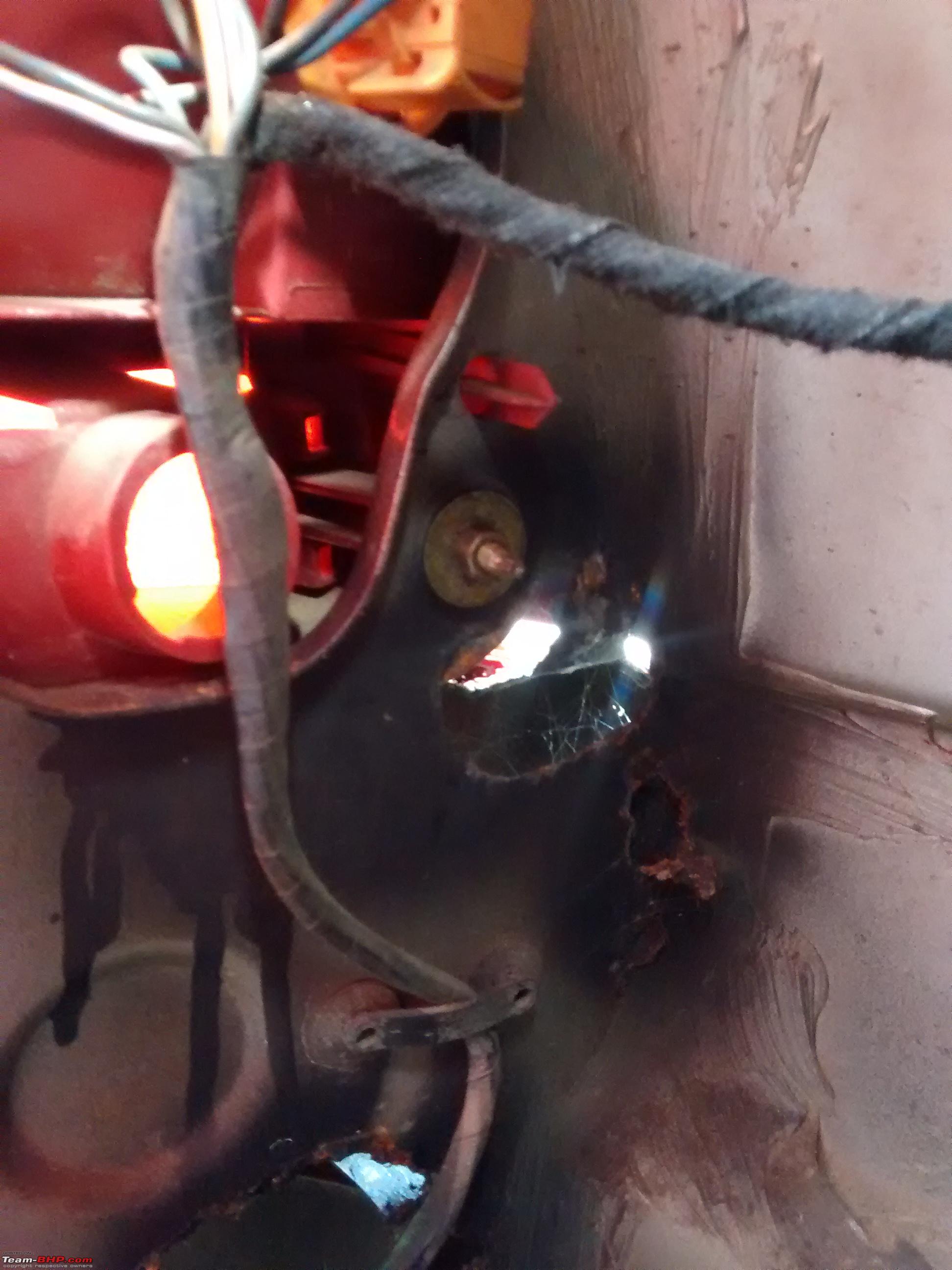

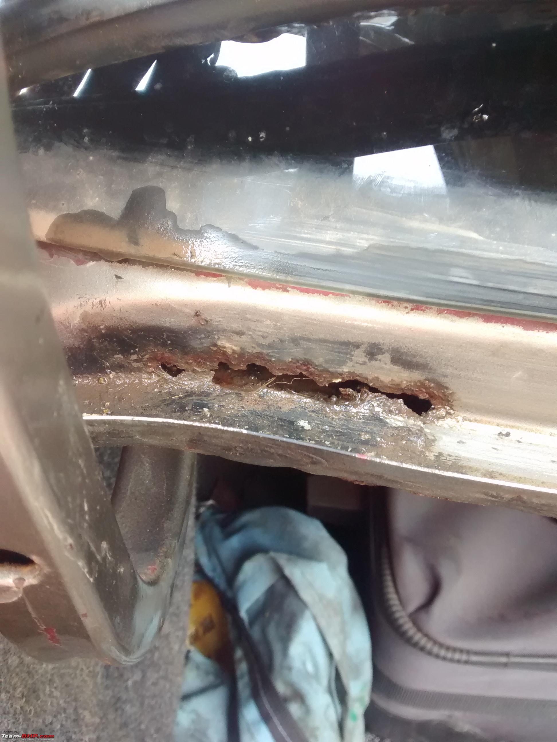

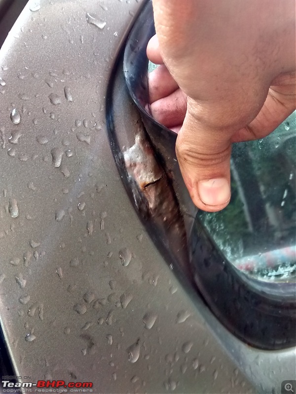

Want to restore my Ford Ikon 1.6 body shell
My Ikon has developed rust on her body for the past 14 years, and now I am planning to do it up, the car runs perfect. The area where the rust has developed is the doors , roof , floorpan , around the rear windshield and the boot area, the majority of the rust is in the rear portion of the car. The reason for the rust is the Mumbai weather, it has been submerged in 26/7 Mumbai floods and the car washer used to do a bad cleaning job. Now another guy washes the car. Is there any place in Mumbai where they do a good job on the body . Attaching the rust pics

That looks too far gone, to be fair, from what can be seen. Lots of through and through, in quite a few places. A lot of cutting and welding would be necessary.
Do you have some shots from a little bit of a distance?

Hi!
This rust is very easily repairable.
Some sections would have to be cut out and replaced though.

On second thoughts, you may be able to get this fixed. Get a new door. The floor pan could be cut and welded. But you'll need someone very skilled to fabricate the portions in the boot and other places.
Someone got his safari fixed with the local mechanic here, similar amount of damage on floor and a rusted rear hatch held together mostly by paint. But he knew exactly what was to be done, and got the fabrication and welding done exactly as per his instructions.
