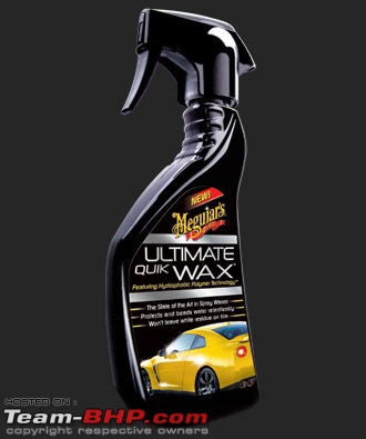

Ultimate Quik Wax®
From the manufacturer’s website: Meguiar's® Ultimate Quik Wax features Hydrophobic Polymer Technology™, making paint come alive with a deep, wet-look shine you would only expect from liquid or paste waxes. And the protection and relentless water beading, lasts for weeks.
• Synthetic, non-whitening formula produces amazing results in just minutes.
• Spray on, wipe off and then marvel at the shine!
Insight: Contrary to its name, this one is a spray sealant and offers a very glossy look. Compared to some of the leading spray waxes, the durability isn’t great but it does hide very minor surface imperfections.

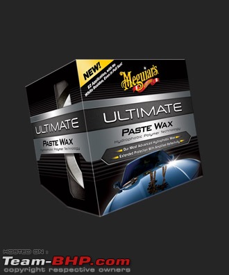

Ultimate Paste Wax
From the manufacturer’s website: Meguiar's® ThinFilm technology delivers our easiest application & removal... even if you have to wax in full sun! We've re-set the bar with a pure synthetic wax that provides extended protection with amplified reflectivity that won't leave a white residue on trim & plastic.
• Our most advanced pure synthetic hydrophobic wax.
• New Thin Film technology makes application easy, even in full sun!
• Extended protection with amplified reflectivity.
Insight: This is the most durable LSP product in the Meguiar’s consumer line. However, it is a sealant and the look is rather glossy and reflective unlike a wax.

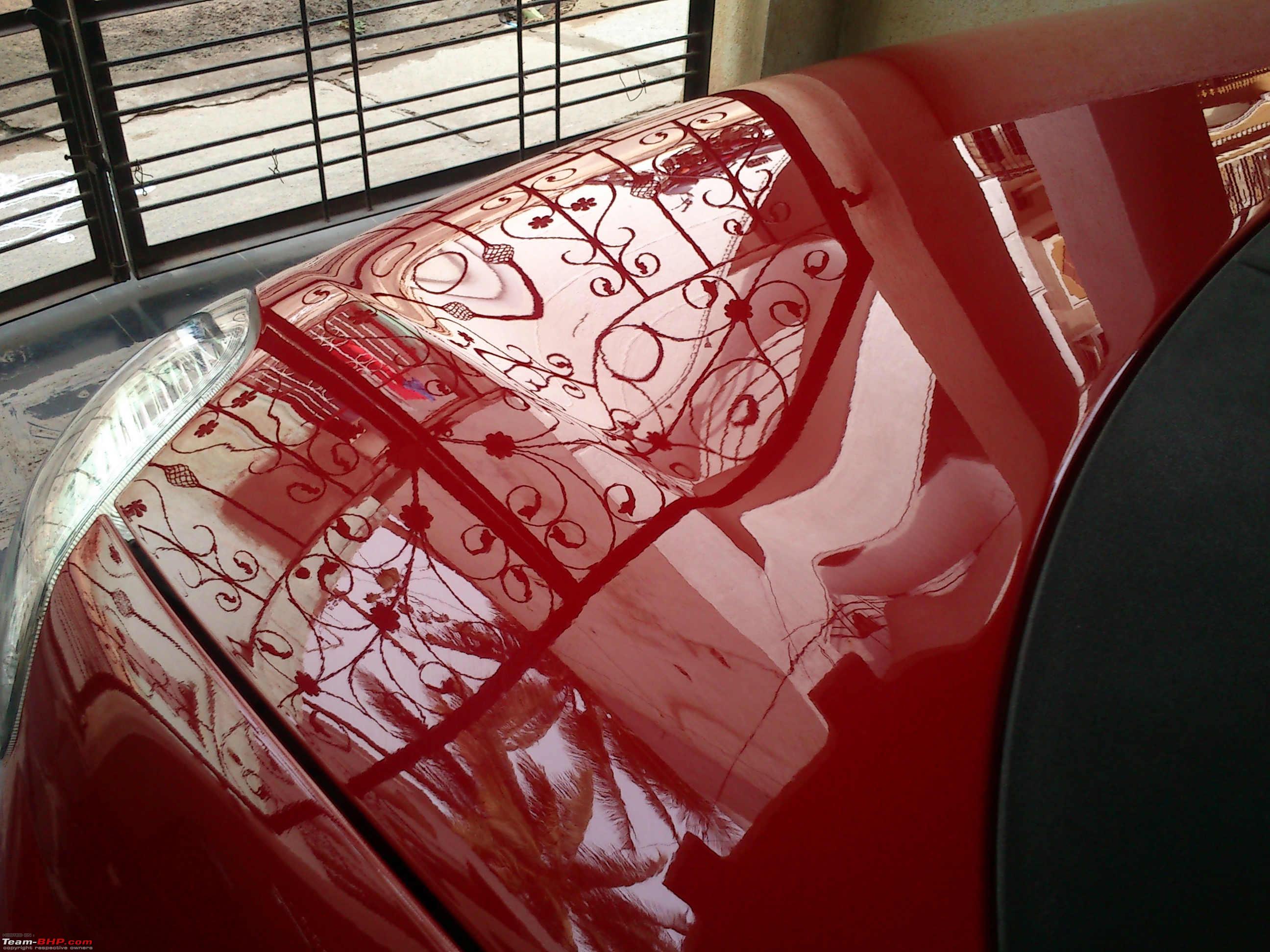

Here is a picture of my car with a sealant,

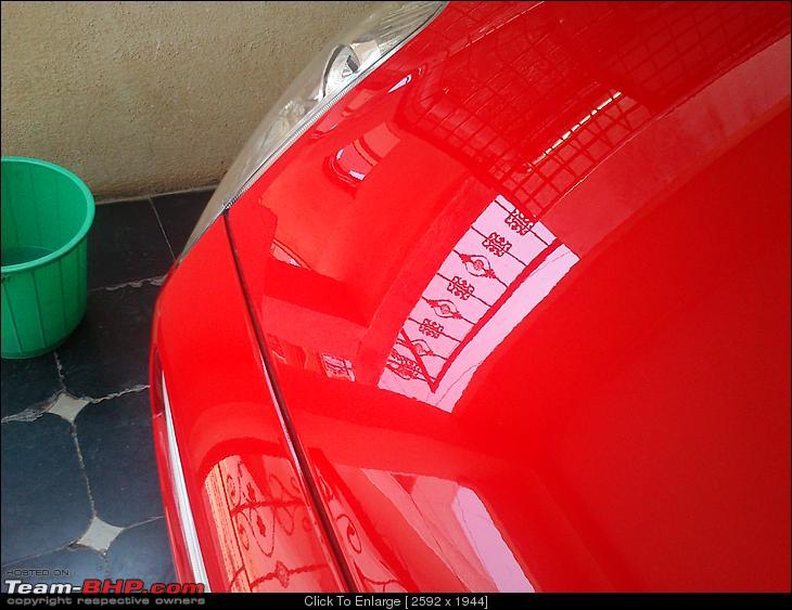

This is after one coat of quality nuba wax.
Best is to try side by side and see for yourself. Neither of them are bad, its a personal choice.
Both are the same car! I guess light is playing tricks here. Or is it the LSP?
But I'm still not clear on what exactly is the difference between warm and deep VS glossy and reflective. Both picture looked reflective enough to the layman in me.
In simple words, Sealants reflect more and hence the extremely reflective look. A typical sealant used on my Blue Punto will give a very reflective look, the metallic flakes will pop and it almost hurts the eyes as far as my car is concerned. With a wax, the reflection will be less and hence I will be able to see the reflections clearly and they will look "deeper" and the overall paint will look "warmer".
This is due to difference in the RI (Refractive Index) of a typical Sealant VS a Wax.
Refractive Index (RI) or Haze Value -when light strikes the surface of a material it bounces off in all directions due to multiple reflections. The most familiar example of the distinction between specula and diffuse reflection would be a polymer and a Carnauba wax. While both exhibit a combination of specula and diffuse reflection, Carnauba wax has a higher proportion of diffuse reflection and Polymers have a greater proportion of specula reflection.
• Mirror (specular) – RI: 1.00
• Water - RI: 1.33.
• Carnauba wax – RI: 1.45
• Poly (dimethylsiloxane) – RI: 1.48
It's the way that the light bounces back from a surface.
Oh yea, both pics are of the same car, and yes the light does play some tricks. Try to see the texture, one with sealant looks more like one more clear coat on it and the second one with wax is more rich and non plasticy ( For the lack of word ) feel to it.
Its hard to explain unless one sees it in person both side by side. Let me see If I could post a 50/50 photo this weekend.
