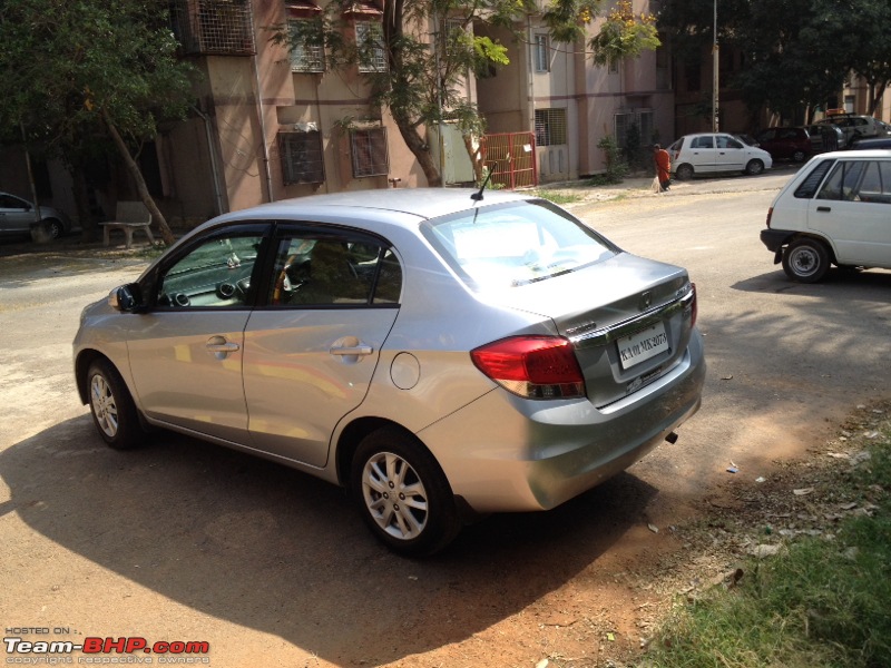

Used Meguairs Ultimate Polish followed by Collinite 915. Haven't done any claying yet. Will do that soon.
Also attaching a few pics of the zen. All this was turtle wax platinum series wax paste
Looking good!
But, contrary to popular belief, worst place to park a detailed car is under a tree!
If given a choice, i would park my car in an open area exposed to sunlight and UV rather than under a tree!
But, I hope that time never comes!
She's always sleeps under her blankets! :D

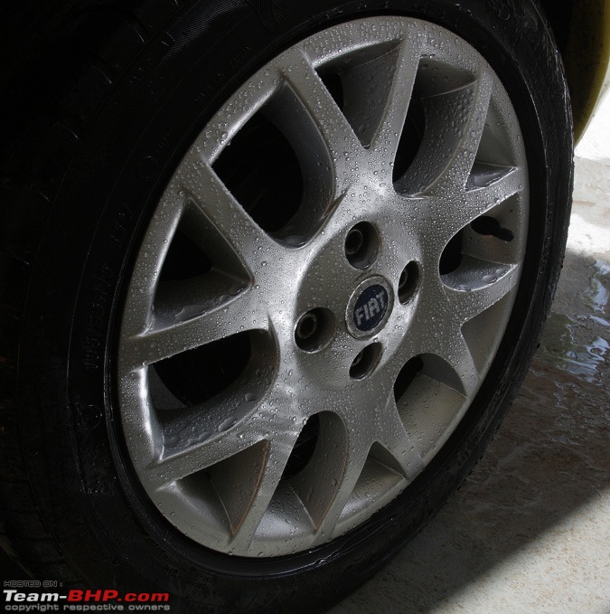

I have tried FK1000P, it looked too glossy for my taste. never used it on paint again but it was freaking wonderful on alloys.
2 coats on alloys and 5 months later -
Example of the torture alloys went through, but still looks and beads well :

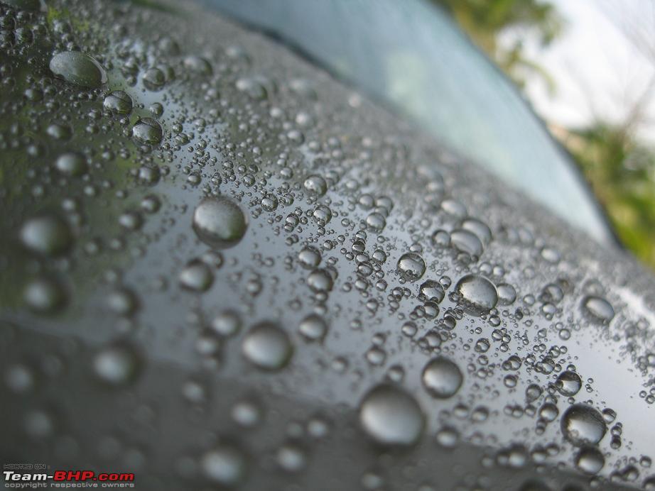

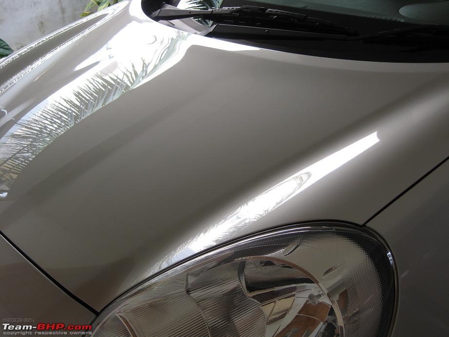

I was looking for durability in a wax and read that FinishKare Hi Temp Paste wax (aka FK BWM101 or 1000P) is good at that. Moreover, bringingbest.in had stock of the small sample tin, so I didn't have to worry about spending big money. It costs ~400/-. Dealing with Sanjay of bringingbest.in was a breeze and he is one who responds to your queries ASAP. Just because I had to add him as an NEFT third party to wire the money, the process took extra 2 days. At the same time, I had placed an order with autotrends.in and was surprised at their speed of dispatch and delivery. Bought a DG dual use foam applicator for around 200/- from Sanjay along with the wax.
Manufacturer's claim:
Made from a blend of synthetic waxes to obtain a high degree of consistent quality. The most important attributes of this wax blend are hi melting points and greater hardness than natural waxes. Thus, the resulting film provides not only the high gloss but resistance to wear from heat, water and other natural causes. It is great for all painted, chrome and fiberglass surfaces found on Marine, Aircraft and Automotive finishes. It is easy to use and easy to wipe off.
Details:
Packaging: 56.7 gm old-school type small sample tin
Directions: Apply with a clean and soft cloth onto an already clean surface in a overlapping circular pattern for uniform film. Allow to dry and wipe off residue with soft cloth. Then buff to a bright, hard, slick and protective finish.
Viscosity: Dried paste
Color: Yellowish
Scent: Not strong. Smell up close and it reminded me of the wax garages used on my dad's old Padmini
Price: INR 395
Made in: USA
Preparation:
Washed the car with Meg's NXT Car Wash. Couldn't get hold on to a sample clay bar and didn't want to spend 1700/- for the Elastrofoam clay foam now. Surface preparation is the biggest thing in detailing than the wax or sealant. There were bug and tar marks all over the side and tree sap, bird poo leaving a light discoloration on the roof. This time, I decided to go with diesel spray and removing much contaminants by hand. Tough job to keep the diesel away from rubber and plastic and to remove umpteen number of spots. Washed the car thoroughly another time to remove the diesel film leftover.
Application:
Applied by hand using the closed foam side of the DG dual use applicator pad. The key is really to buff in the wax in circular motion. Just rub the applicator against the wax in the tin and start buffing a panel in circles till you can notice a uniform circular pattern. It is difficult to judge how much wax you take on to the applicator pad. A polisher would highly reduce the manual labor of buffing here. Wait for a few minutes and wipe off with an MF cloth. Here also, wiping multiple times will clear off the wax and leave a super slick panel. Take care not to over apply the wax else you will have a hard time wiping off. What is left is like a coat of clear. I liked it, I love to glide my fingers over all day; but the effort was too much. Now I realize the need for a Jopasu duster.
Buff in buff in and buff in.
1-2 pass of buffing is not enough.
See the pattern spreads evenly after several buffs.
After doing some panels, even when you don't take wax from the tin, your pad holds enough wax to buff a section. This is what is left after I was done with the whole hatchback. Close to 1/3rd used up.
The wax and the applicator pad. The pad may not outlast the wax.
Sanjay of bringingbest.in suggested a similar application to Collinite 915 Marque D` Elegance.
Different passes while buffing.
Repeated circular buffs do the trick.
Before and after does not do well in pictures. Touch and water beading are the best feelers. Front door (to the left) undone and rear (to the right) done with buffing off.
Bonnet all done.
Basking in the sun. Sorry, alloys not done.
Impression:
Glaze : Excellent with good water beading initially. Bit candy like, which I personally liked for the silver Micra.
Durability: Can't comment exactly. Will come back on this later.
Ease of use: Moderately difficult.
Satisfaction (difference between done and undone panels, water beading) just after waxing: Excellent. Touch and you'll want to touch more.
VFM?: Yes I guess. INR 400/- would get you 3 coats minimum. Further comments after checking durability.
