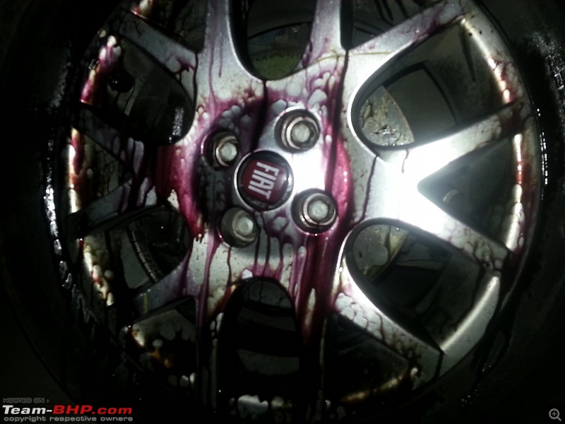

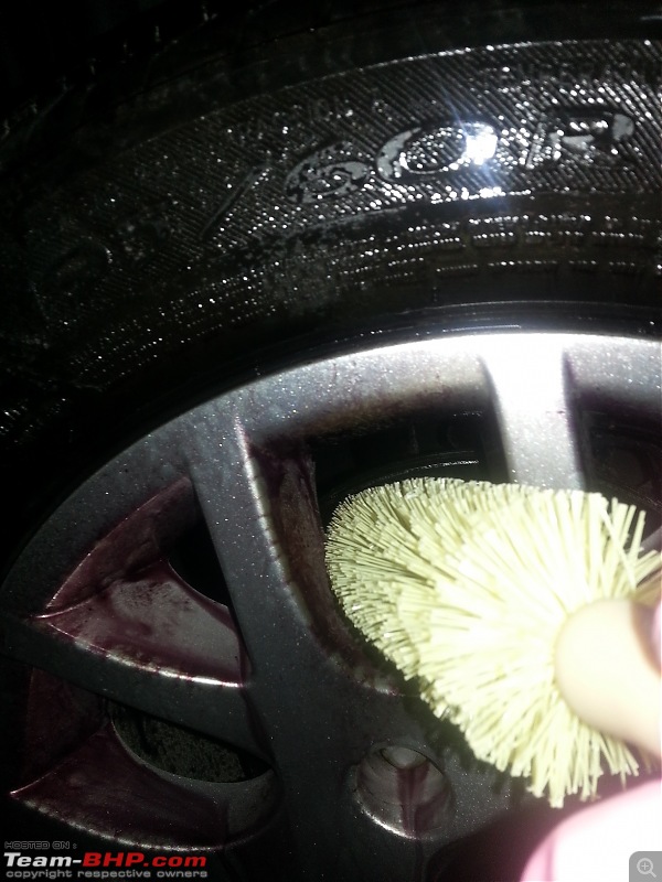

Wheels First: The wheels were washed with Sonax Full effects Wheel Cleaner and unlike other bleeding style wheel cleaners, this is a wheel cleaner & fallout remover rolled into one product so no need to wash your wheels, then use fallout remover and wash again. Just spray, wait for the reaction, agitate if required & rinse.

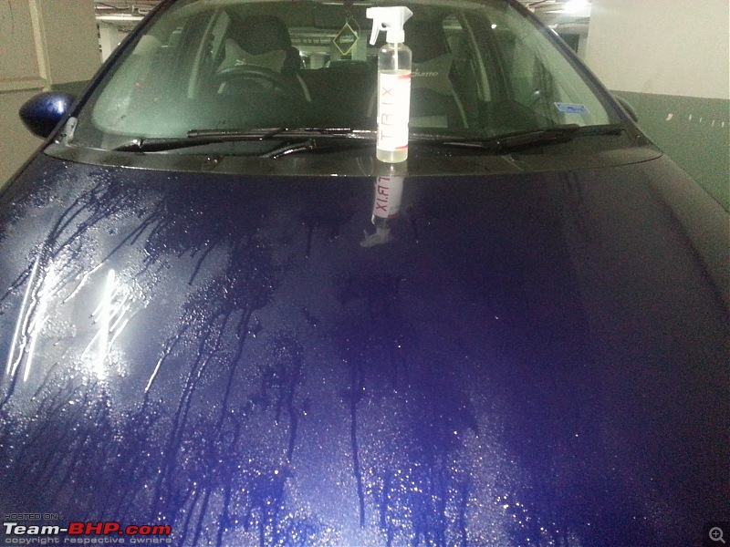

Decontamination: Since I only planned to use their coating on the bonnet, I quickly washed it with the Sonax Xtreme shampoo and dried it. After that, Carpro Trix was used on the panel. No reaction so there wasn't any fallout but it still managed to break the traffic film and remove all greasy residues. After this step, the entire car was washed with shampoo & dried. Sonax offers both Fallout Cleaner as well as Tar remover & both are readily available in India. I had already invested in Carpro Trix so will get to try the Sonax products once I am through with the Trix.

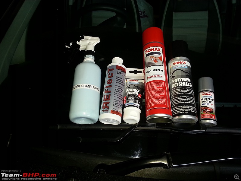

Polishing: I tackled a random deep scratch with Optimum Hyper Compound on a CG Hex Logic compounding pad. Then I moved on to using the Sonax Perfect Finish polish on a Sonax Orange Foam polishing pad. The combination corrected very well and the finish was spectacular. Just out of curiosity, I tried Carpro Reflect polish on a LCHT finishing pad and though it added a slightly more gloss; it wasn't required after this polish. SPF (Sonax Perfect Finish) is a true one step polish as far as I am concerned. The pad cost around INR 550 while the 250 ml polish cost around INR 1,000

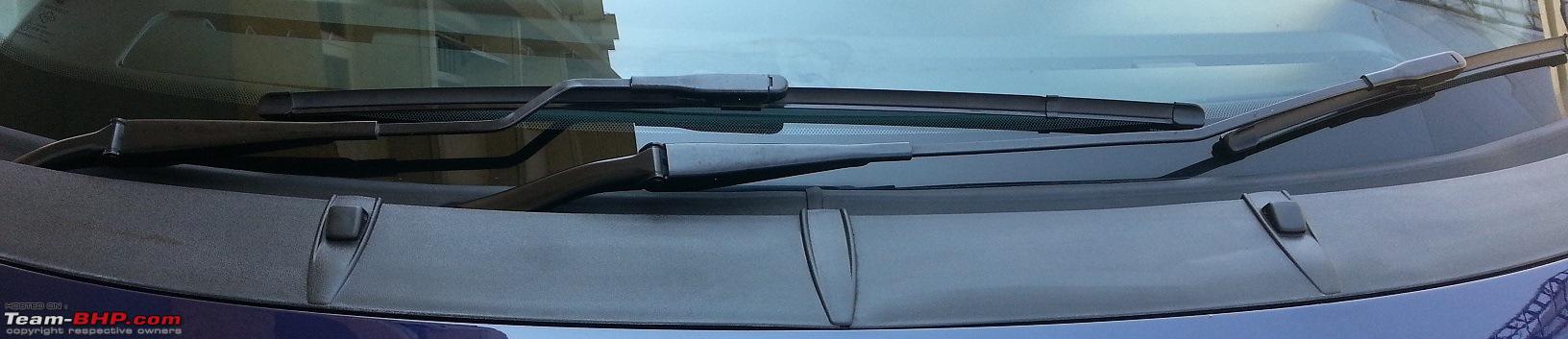

Trim Cleaning & Dressing: I worked without masking tape on the cowl for a reason. I wanted to test the Sonax Dirt Eraser sponge and whether it will work with water to thoroughly clean the plastic. And it did. The cowl was dressed with Sonax Profile Trim Restorer.

Panel Wipe: The polishing residue was removed with Sonax Paint Prepare.
Coating: Sonax Nano Paint Protect coating was used. This isn't a so called "Permanent" coating. It claims to protect for one year. At INR 1,500; I am not complaining.
Sealant: Sonax Polymer Netshield is a hybrid sealant that comes in an aerosol can and is the recommended topper for this coating. The coating was allowed to harden for one hour and then the PNS was applied.
