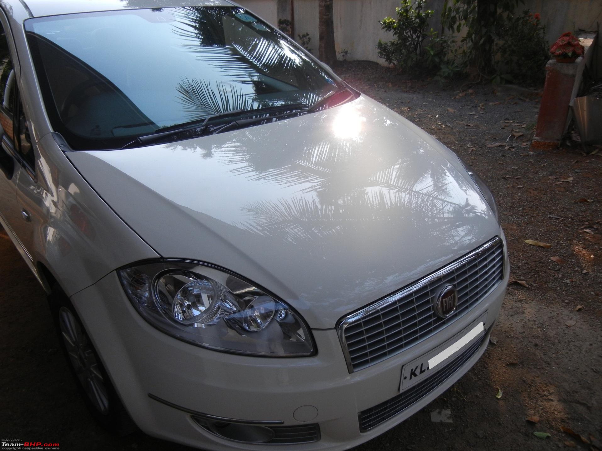

I had bought Formula 1 liquid carnauba wax two weeks back and used it on both of my rides. I bought the liquid one thinking its pure wax but later found that even this one has micropolishing agents or abrasives. I am a complete newbie to all this detailing stuff so please help me with my doubts. Can I use this wax on my car every 3-4 months? Will it cause any permanent damage to the paint and will my car look worser than what it was earlier after 2-3 months once the wax is washed out? After using it both my cars look glossy now and water beads out nicely too. Dirt doesn't stick to the car like earlier and cleaning is also easy. Swirls remain the same though. I first washed the car, dried it, gave it a coat of kerosene to remove all the tar and other stuff and then washed it again with plenty of sonax gloss shampoo. Then applied the wax. Also used tire shine but by the time pics were taken most of it was already gone. This was my first detailing session. Pics of the Polo were taken a week after applying wax while that of the Linea the next day. Can someone suggest me any kind of pure wax that can last for a few months and any shop in Cochin where I can get it? I couldn't find Collinite or other good brands in this shop and ended up buying this one for 600Rs(actual cost 356/-).

Re: All about Car Waxes & Sealants
Here are the pics again. Don't know what happened earlier as the uploaded pics never showed up.

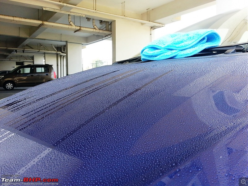

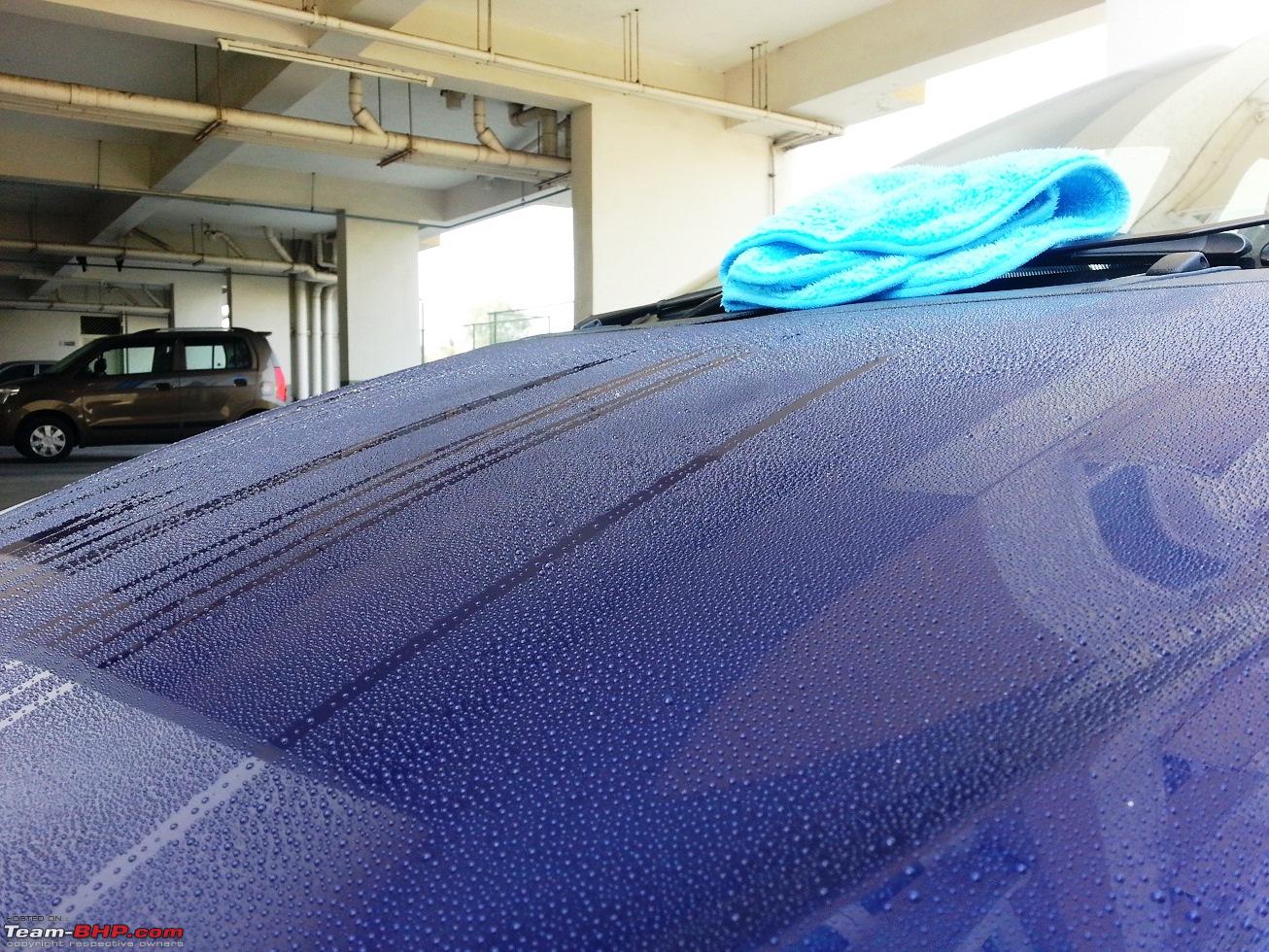

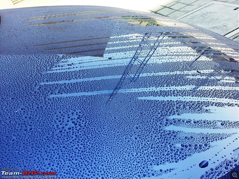

Sonax Brilliant Shine Detailer
I have been following the discussion on international forums about Sonax Brilliant Shine Detailer for a few months and initially I refused to buy into the hype. It seemed too good to be true. A quick detailer that works like a spray sealant, costs a fraction of the nano spray sealants out there, has exceptional water behavior, darkens the paint a little, goes over coatings, waxes, sealants or even as a stand alone LSP? My initial reaction was to just ignore the discussion but then both DIY detailers & some very reputed professional detailers/testers continued to challenge what the product could do. What caught my attention was it's ability to keep the car cleaner, for longer. I thought I have heard that many times earlier as well and how these products perform in the UK or USA is very different than how they may perform in India. Finally, a reputed & unbiased tester started challenging it for durability, water & anti static behavior; and after reading it I was tempted to try it.
I washed my car with Sonax Xtreme shampoo and applied Sonax Brilliant Shine Detailer to the entire car about 10 days ago. The car has no other wax or sealant at the moment. The application was easy - spray, spread, buff. It instantly added a brilliant shine and the slight paint darkening was visible. After that, I restrained from using any water less or rinse less washes. I have only been using Jopasu duster once a day and I noticed that the dust seems to sit as a very fine top layer that is easily removed by the duster. I then drove down from Chennai to Pondicherry and exposed the car to the Auroville dust, parked in the open under direct sunlight for two days. I spot treated a few bird droppings with a water less wash and they came off easily. Other than that, the car has not been washed at all for almost 10 days and about 600 km for this period. I have used several waxes and sealants but nothing has kept my car this clean, for this long, with so little work. I have not used any coatings yet and I may have given in to a coating sooner than later as I was getting tired of the whole dust thing. This product will not offer the mar resistance that you would get from a coating but in terms of it's self cleaning ability, it is a fantastic product. It will go over every wax, sealant or coating that I may try from here on.
I have attached a few beading pictures that I took this morning and a few from the recent trip to Pondicherry.

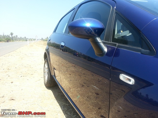

That beading is epic . I have also been experimenting with few Sonax products, reason being they are cheap and locally available. Might I say, I am impressed with their range I have used so far.
Here is a picture for your viewing pleasure, This was a test section which I experimented with Sonax Perfect Finish polish, Sonax Protect and Shine and topped with Sonax BSD.
I am planning to do the whole car with the above combo in a week or two and post the results with a review, when the time permits.
