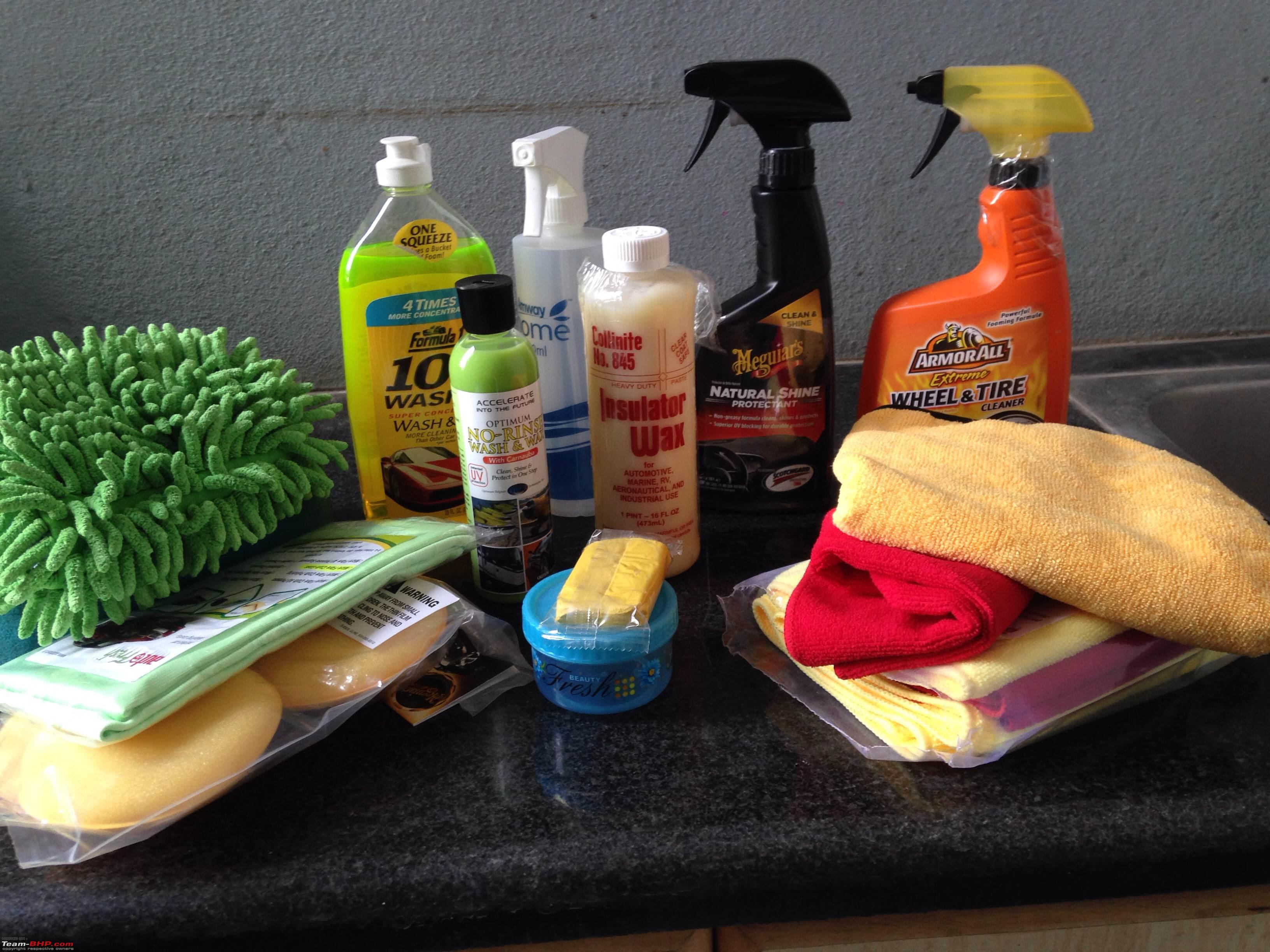

Hi Guys,
Today I detailed my car for the first time and I was really looking forward to it as this was also my first detailing session. After watching numerous videos and putting in countless hours going through these various detailing threads on Tbhp, I must say i had the basics clear about the process. But, I must admit, execution is altogether a different thing. Here is a quick summary of the 5 hours well spent.
1. Started the process with dusting the car interiors and washing the floor mats thoroughly. For longevity of Dashboard, used Meguiars Natural Shine and Protectant on Plastics that bear the torture (especially since tints are barred). Wiped the residue off with a MF for a matt finish. Now Dashboard looks clean and refreshed and interiors also smell nice.
2. Car required a thorough wash as there is lot of dust that settles down on the paint due to the ongoing construction in the neighboring areas. So, started with rinsing the exteriors as generously as possible, followed by the shampoo using the 2 bucket method as advised and then drying the car. For drying, I followed a method that i saw on a youtube video in which instead of using the after magnet immediately after the wash, you wipe the car with a damp MF and then putting the drying towel to use. Found it pretty effective and I believe this might reduce the swirls. Only time will tell.
Products used: Formula Wash and wax , Jopasu Magic wipe (damp MF) and X-static Aqua Magnet.
3. Tires and alloys cleaned with Armorall All wheel cleaner to bring those shoes back to their original beauty. Missed having the Hot shine tire foam (next on my list).
4. Next was claying and this was something I was going to do for the first time. I had bought 80 gm clay from Keystone Enterprise yesterday and was itching to see it in action. Also, had got ONR WnW 8oz to be used as a lube for the clay. Found the bar to be a little big, so decided to cut it in 2 and use one for this session. Sprayed the lube pretty generously to ensure that clay moved pretty easily over the surface. A 500 ml solution sufficed for entire Terrano, even though i was pretty liberal at using it. I also clayed the windshield as i was finding it be a little rough while cleaning over the last few days. The surface has become super smooth now and daily cleaning with ONR should keep things simple from here.
Now here comes the interesting bit, Over the last few days wifey had been noticing my obsession with detailing products and related videos. I think some of it must have rubbed off on her as she started asking a lot of questions about the products and their usage. So, for today's session, she decided to accompany me and take a look. She was pretty intrigued by the claying procedure and decided to take matters in her own hands. After a few misses, she started enjoying herself and I also went along as it gave my sore muscles a much needed break and to be fair, she was better at it than I was.
5. Now comes the much awaited part and my favorite, sealing the hard work with a protective layer of Collinite 845. Since I started reading about detailing, I have heard about this product more times that anything else. So, i wanted to see for myself what the fuss was all about, and i must say, I was simply blown away. Using Meguiars applicator pads, i started putting a very thin coat and i was surprised to see how much area a drop of this amazing product can cover. Took my time doing it to the entire car and ensured that there were overlaps while applying. it was already 07:30 pm by now and i was ready to collapse anytime. But, one final step had still remained, Buffing.
Nirmal was really nice when I bought Col 845 and ONR from him yesterday and threw in a plush MF for polishing. The towel did its job really well and at the end of the day, it was great to see the effort bringing out the richness in color and that deep shine.
I was unable to click any pics of the car as it was really dark by the time I was done and pics from phone are not that great. Would try to click a few in the morning and share afterwards.
Attached is a pic of the armory.
Happy Detailing guys.
